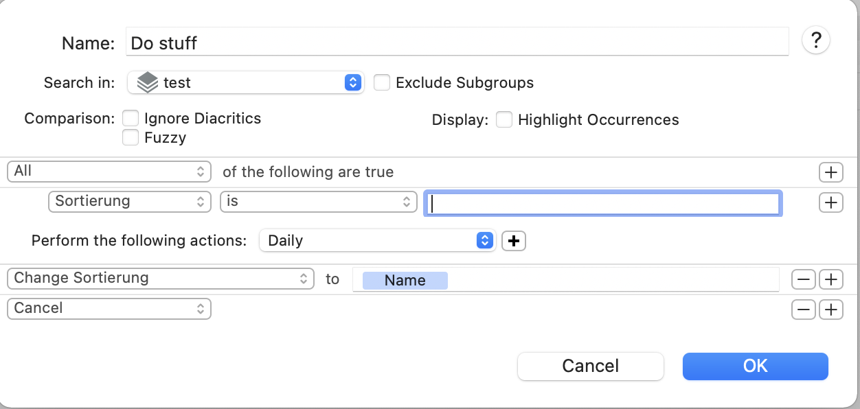

I actually think that could be done with a simple smart rule. In the image below, my custom metadata is called Sortierung; obviously I would use Filename or similar for the purpose at hand:
That rule should scour the databases adding the file name to custom metadata for any file for which that custom metadata is currently empty.

A Smart Rule with trigger On Rename
could keep custom meta data up to date.
