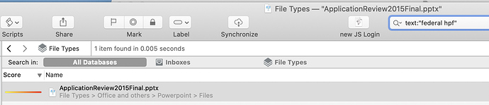

There is no exclusion.
Powerpoint files can be imported and viewed in DEVONthink.
If the slides have text, i.e., not just graphics containing text, they are also searchable.

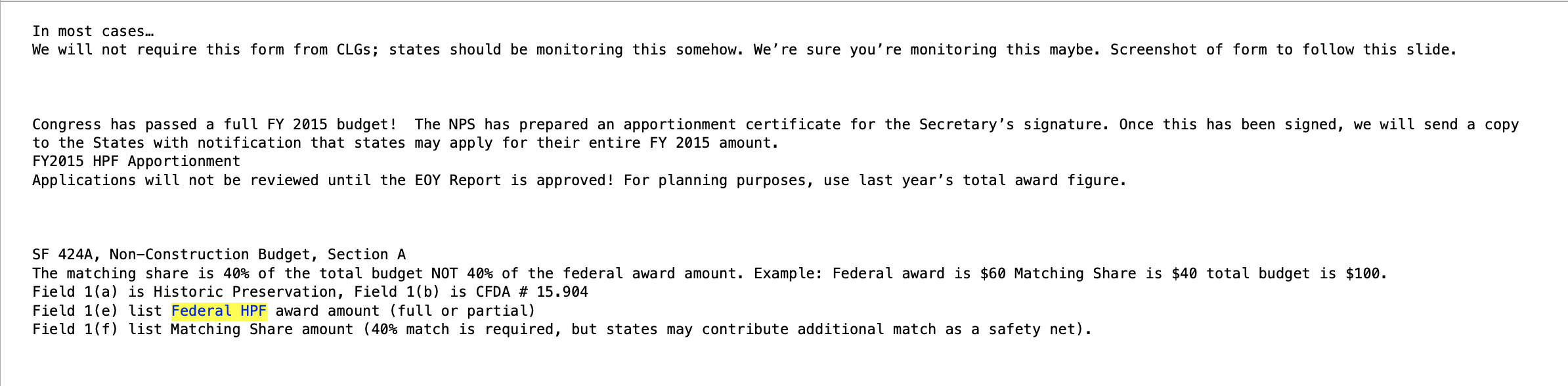

And using the View > Document Display > Text Alternative in DEVONthink 3 Pro, you can see a highlighted search hit in the text of the document.
Search hits cannot be shown in the rendered slide, due to liimitations of Apple’s QuickLook frameworks.
Thank you for your reply! So my configuration seems to be different from yours, since it doesn’t work like you show in the screenshots. My pptx files do contain text, not just graphics, as I can see when searching the keywords with spotlight or using the internal Powerpoint search. I can search, find, copy or edit any given word in the presentation. Yet DT3 cannot find any text. And when I try to change the view to “Text alternative” the options are greyed out. There is no choice but staying with the preselected “Best Alternative”…
You need to be running DEVONthink 3 Pro for the Text Alternative view.
Additionally, it’s possible you may need to do a File > Rebuild Database to ensure the index is up to date.
Dear Bluefrog, kudos to you - this was very helpful. I am running DT3 Pro, so this was not the issue. But rebuilding the database solved my problem. Now I am able to search/find keywords in Powerpoint files and switch into “Text alternative” view. Thanks a lot!
