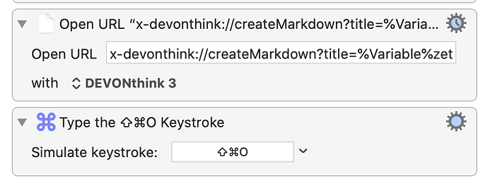

I posted screenshots of my actual setup in KM:
Unfortunately the selection does not work correctly and i’am stuck seeing why :face_with_head_bandage:
I tried to post the whole macro but i’am a new user and cant post more than 1 screenshot.

Why are you using the URL command?
Bear in mind that is not an x-callback URL (which are not supported in DEVONthink), so it’s not going to return a value.

Is there any other way within the boundaries of Keyboard Maestro to specifically select a newly created markdown document?

As a new user i am only allowed putting one picture in each reply.
Ok, so instead of using the name as a defining feature for the smart rule, use the contents, which will always contain “Note/Resource ID:”, “Schlagwörter:”
An alternative (which I would use if I were using various methods to create such MD files, and they all triggered my smart rule although I didn’t want those from a different source to do so) would be to include a destination in your URL, so that the new file is created in a group (called “new MDs” or whatever) and then moved by the smart rule from there to the inbox and then opened. That would limit your smart rule to those MDs being created in that specific group, so you could use “kind is markdown” as your only criterium.
