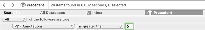

Nope. That is detecting files with associated Annotation files. Look for PDF Annotations.
Thanks for clarifying, @BLUEFROG! Is this the intended way to identify records with PDF Annotations?
The textbox next to the drop-down operators never expands larger than this, so I am thinking this is the only way to search for documents with annotations and that it’s not possible to distinguish between different kinds of PDF annotations… Is that accurate?
Also, this begs the question whether this returns only PDFs that have been annotated within DT, or whether PDF annotations applied in, e.g., Skim or Preview will also be found in this search.
That is a macOS control and only handles numerical values.
That is correct. It is a count of all annotations, regardless of type.
Skim and Preview annotations will be detected and counted.
