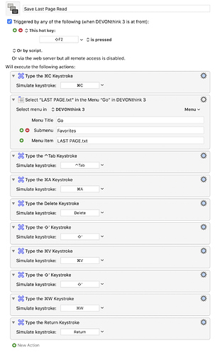

Since I haven’t been able to figure out how to Annotate a PDF, or search for a highlight, I created two Keyboard Maestro macros, one to save a search string, enclose it in quotation marks, and paste it into a file I call “Last Page”, and which I keep in my Global Inbox.
The second macro opens that “Last Page” in my Global Inbox, copies the text, and searches for it.
It works very well, and very quickly.
