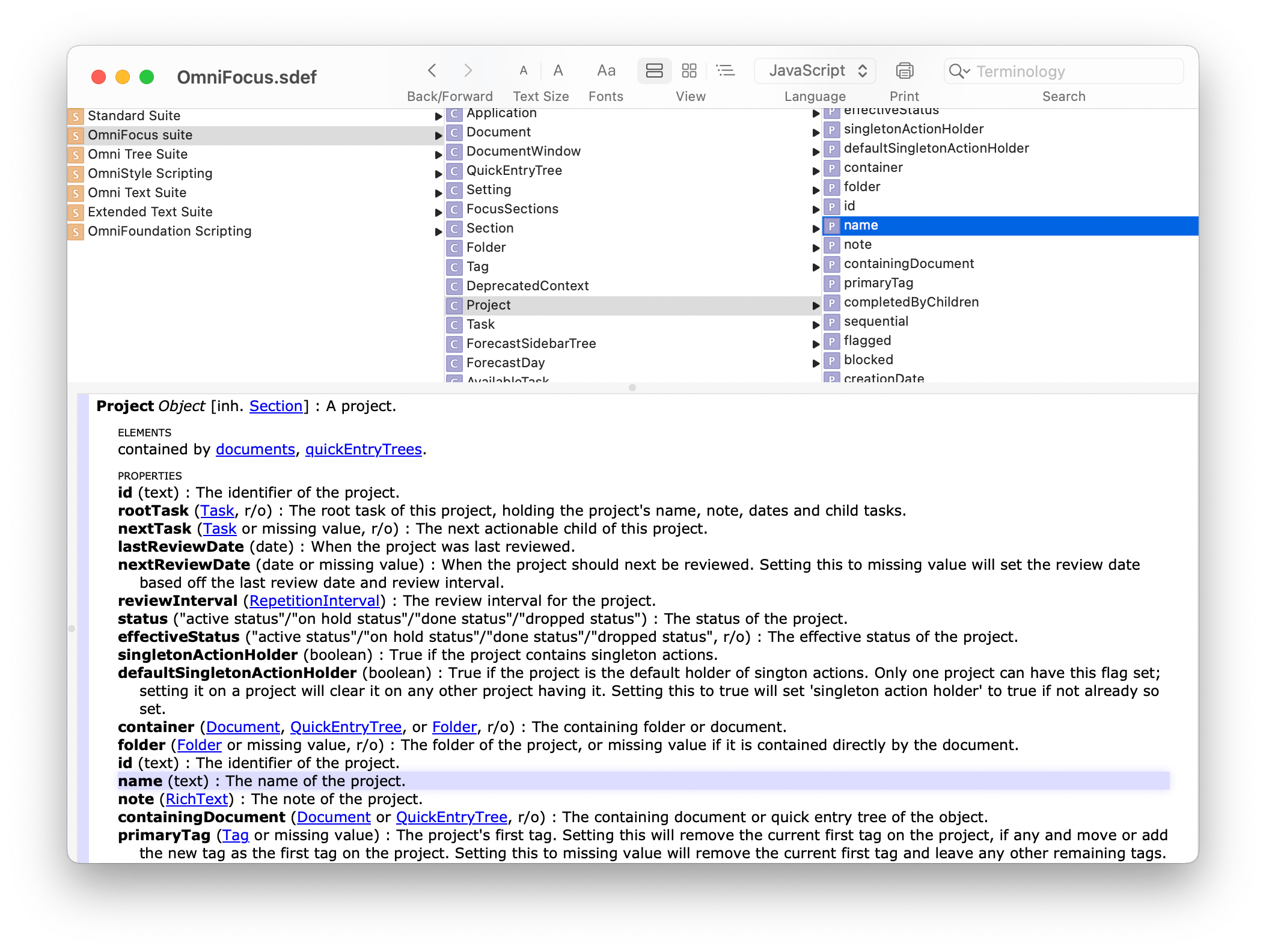

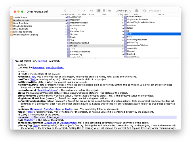

I just downloaded OmniFocus to take a quick look at the scripting dictionary. It’s pretty extensive. Is there a particular reason you want to implement this via Omni Automation instead of JXA/AppleScript?
Anyways, there’s a whole section on the Omni Automation website about working with Shortcuts. You should be able to pass data from an Omni action to either a AppleScript/JXA action or a DEVONthink To Go action.
It looks like you can run shortcuts from inside the application after your set them up, see Omni Automation: Calling Shortcuts

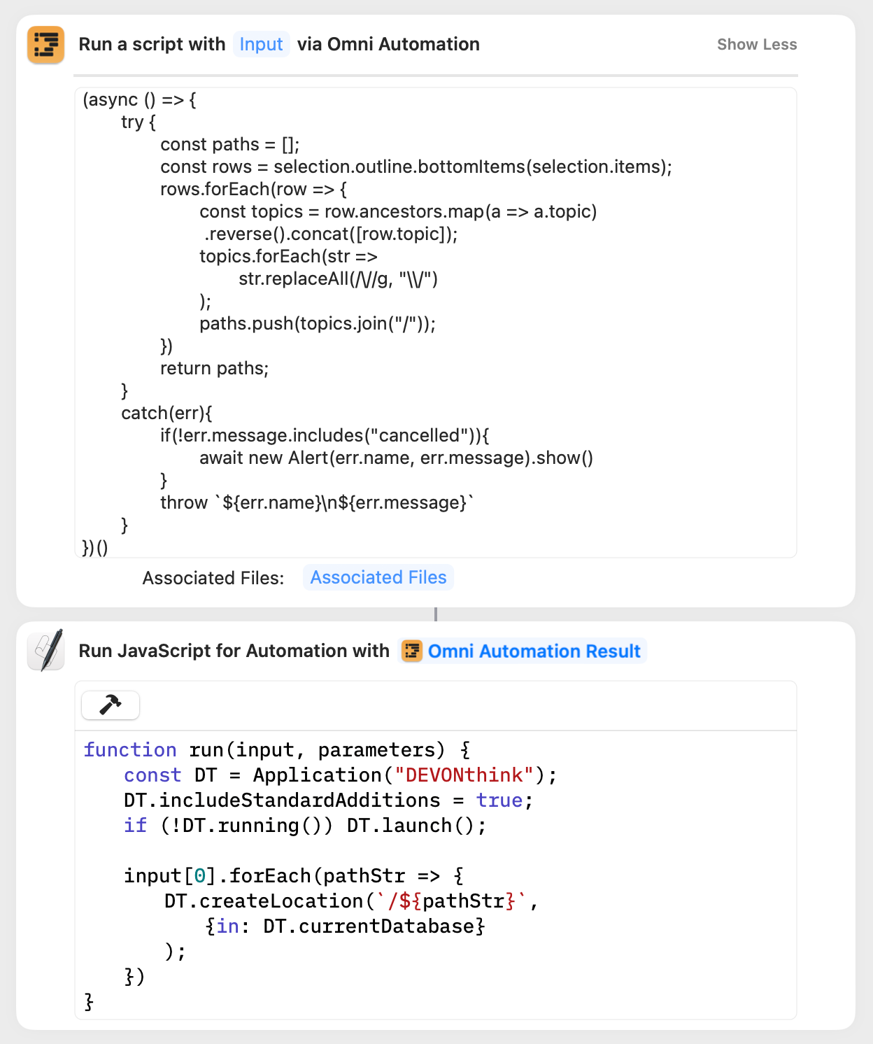

I’m more familiar with OmniOutliner, so I’ll use that for an example: creating a group hierarchy in DEVONthink from selected outline rows.
With Omni Automation it does seem like I need to use Shortcuts. I build one consisting of two parts:
And then a plug-in calling the shortcut:
(I just used the first template from the link in my previous post)

Instead I can do the same with a single, short JXA script:
	const DT = Application("DEVONthink");
	const OO = Application("OmniOutliner");
	const sel = OO.documents()[0]?.selectedRows;
	if (sel?.length > 0) {
		OO.expelAncestors(sel).forEach(row => {
			const pathStr = row.rowpath.name().map(
				name => name.replaceAll(/\//g, "\\/")
			).join("/");
			DT.createLocation(`/${pathStr}`,
				{in: DT.currentDatabase}
Maybe I could merge the Omni Automation Script from the shortcut into the plug-in code directly to make it shorter, but the pure JXA solution still seems simpler.
