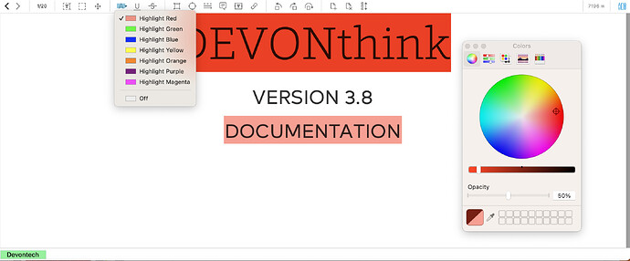

Thank you for the screen recordings! Are your custom colors slightly transparent? This would explain the inconsistent colors of the overlapping, highlighted lines.
Indeed, he is…
60f6eaf109589e95c7cdbb1f3d98582f1e398f1d_2_690x386
I’m not sure an opacity should even be supported in label colors. The annotations essentially use a Multiply mode so they’re not opaque in use.
Here is a highlight pre and post-opacity change, also showing the color in the Highlight dropdown does reflect the color with the reduced opacity. Also note the full opacity highlight on DEVONthink isn’t opaque.…
Yes, I am — is that the issue? The odd thing is that I was using it without any issues for many months, and this just started happening…
It does appear that I can get a rather similar effect just by making the color lighter—and that has the benefit of not having the visible overlapping effect you pointed out, either!
I don’t care at all that it be transparent—I just found the default red very hard to read, and for some reason was able to select and successfully use semi-transparent colors for many months, right up until a couple days ago.
Do you suppose there’s any easy way of fixing documents that were done with the transparency but now show the default colors? If not, it’s obviously not a big deal—mostly I just appreciate having this figured out!
There’s no easy way, e.g., not a button to push. It’s an unusual request for sure.
