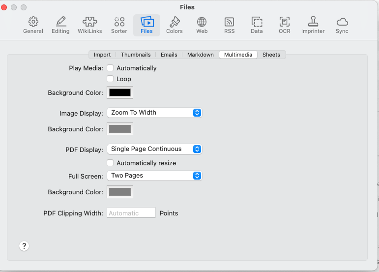

I went to my Menu → Preferences → Icon Files → Tab Multimedia and for the above “PDF Display” was set for “Single Page Continuous” and “Automatically resize” check on. [I don’t remember ever changing that]
I changed “Automatically resize” to OFF, and re-ran the 1Pg PDF tests:

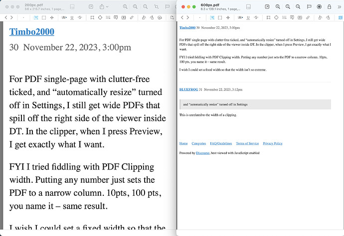

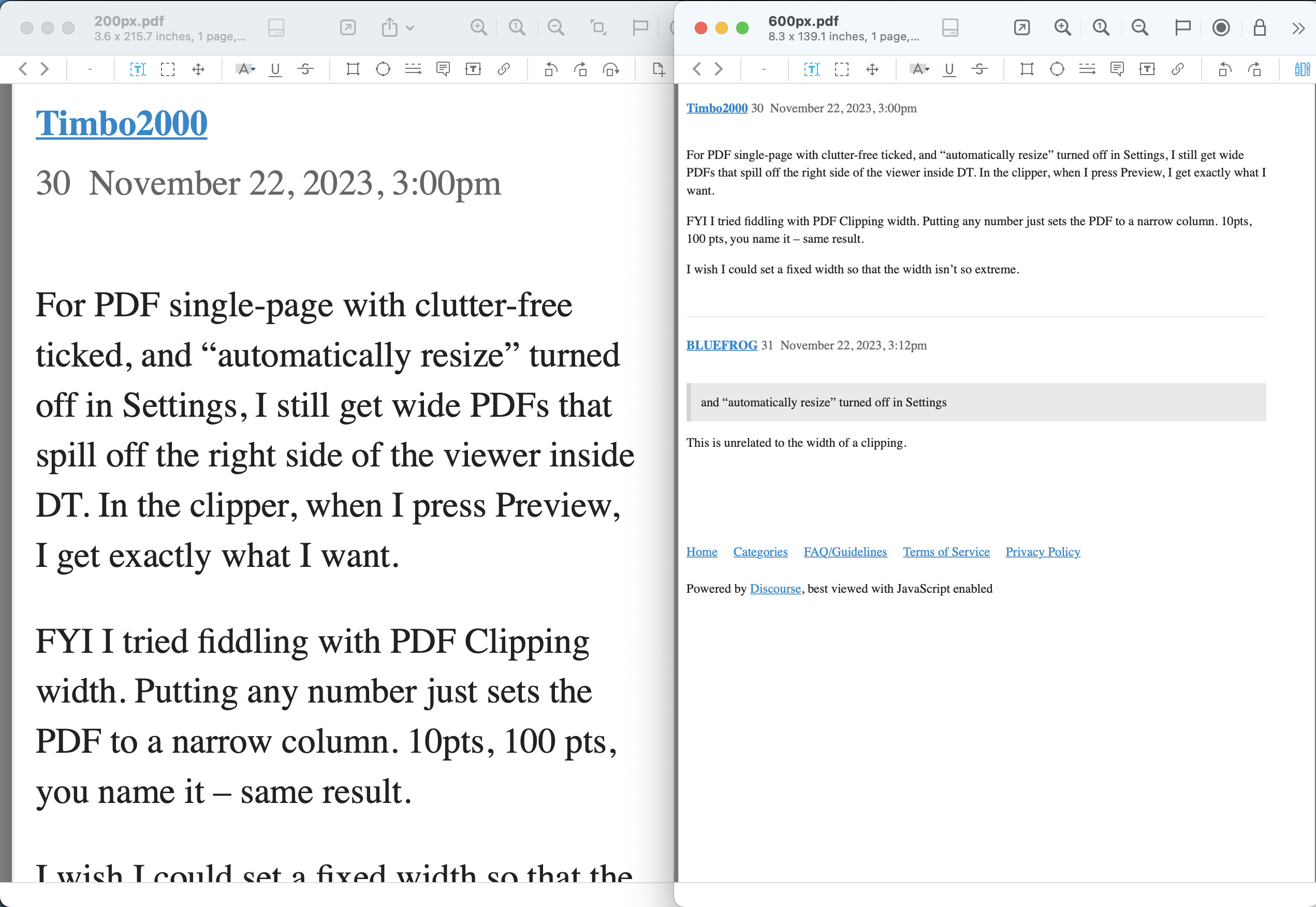

For PDF single-page with clutter-free ticked, and “automatically resize” turned off in Settings, I still get wide PDFs that spill off the right side of the viewer inside DT. In the clipper, when I press Preview, I get exactly what I want.
Turns out the default width is 1920pt, so I just set the PDF Clipping Width to 600 (instead of automatic) and got what I wanted.
This is unrelated to the width of a clipping.
Also…
The pixel width used is in the title.
Please provide a problematic URL as it’s clear this isn’t a global issue.
Can’t provide links in my post for some reason. Check out www_asktheheadhunter_com/resume-blasphemy
If you try it with no clipping width set vs. 600 pt, you get either a 1920pt wide PDF or a 600pt wide PDF.
612pt is width for 8.5"x11" so I’m cool with that.
