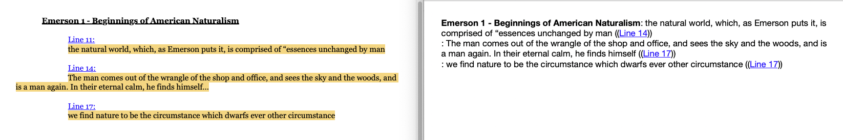

Hmm, I’m finding that the script is not assigning line numbers correctly in a couple ways:
The first link is not being used for the first highlight is using the link for the second highlight, and then the last hightlight just repeats the second to last link.
See how the first highlight “the natural world…” doesn’t have the link to line 11, but line 14.

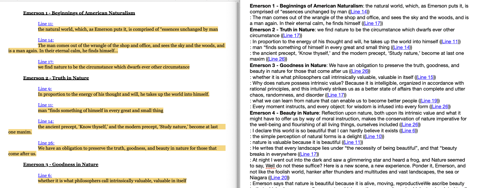

Also if you create one highlight summary from multiple documents (shift select the docs, then run “summarize highlights”), and run the script on that, the last highlight for each document gets moved to the document that follows it:
See how line 17 (“we find nature to be…”) is appearing not at the end of the document “Emerson 1” but at the beginning of the document “Emerson 2”.
To fix that glitch I encountered, I took a stab at revising your script. I ended up streamlining how it ran as well. This code is not as robust as yours, but since the summary highlight docs have such a consistent formatting, I could make some assumptions about what goes where.
This will work with summaries made from single files, or multiple files.

Here’s a few details on the matter:
That’s annoying.
The location of the shell script really doesn’t matter in the end, you’ll just need to change the path of the shell script at the top of the AppleScript file.
