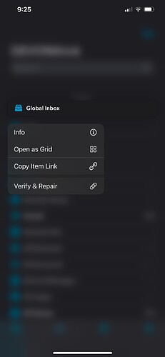

You should see…
are you doing that on exactly the same screen I posted above? So not from within the database, but on the main screen.

On trash bin or reading list I get a context menu. On global inbox nothing happens.
