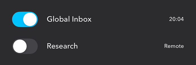

Hello, I’m writing with an issue that I hope I can explain clearly enough. I am running DTTG 3.8.15, and I have a database called “Research” that I’ve synced to DTG using Bonjour. The sync was not working, so at a certain point I turned the database back “off” and then “on” in the “Locations” menu. Unfortunately, when I did that, this created a new, duplicate “Research” database in the app, which only downloaded files from my computer. The old database contains various new files and other updates that I want to sync to DTG. So I went and deleted the new database, but now it seems that I have just severed the link to the database on the computer, as (I think) the attached screenshot shows. How can I get DTG to talk to the original database on DTTG again?

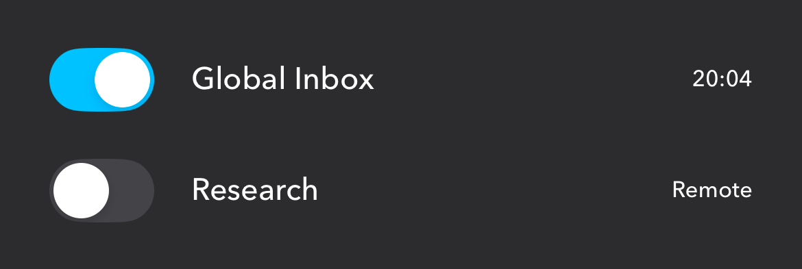

What about turning that toggle on again? As long as it’s off, you won’t sync this database

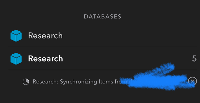

This brings back the duplicate database, in other words the one that is synced to DTG, but does not include the new files / updates I made in DTTG. Attaching a screenshot for ref.

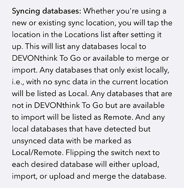

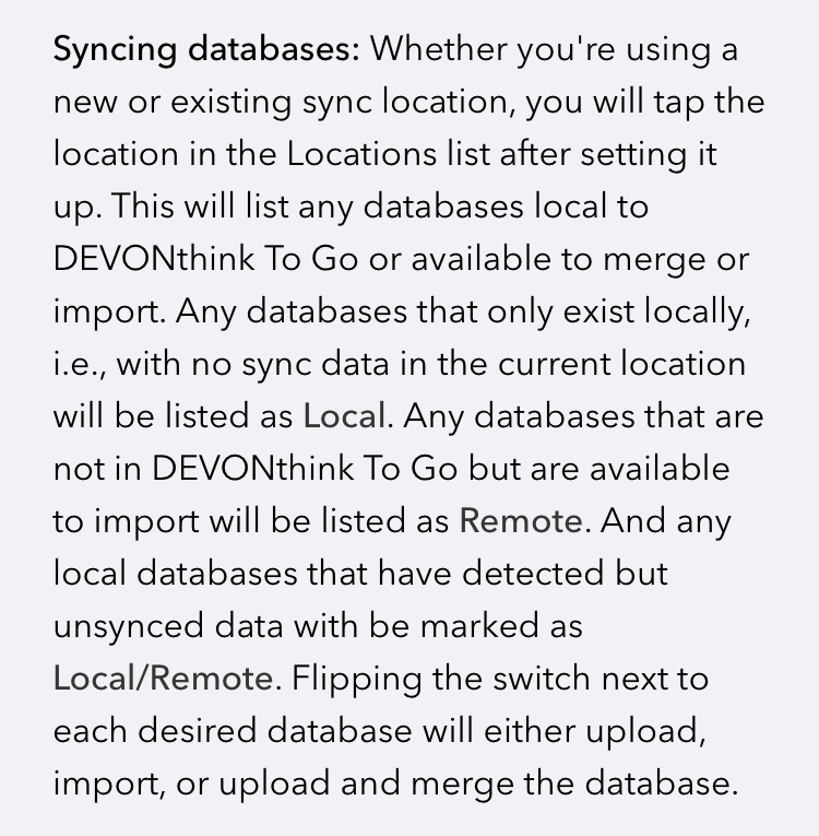

This is what the manual says:
It seems strange that the local “Research” database is not listed among the available databases…

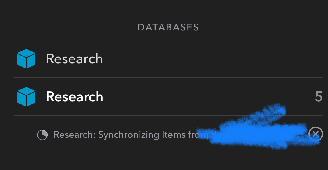

Upgraded DTTG now, and it seems that the overall situation is the same, in other words I am syncing to the duplicate database.
The Mac database doesn’t reflect the content I created on DTTG, but I could transfer over most of those updates manually if I had to.
