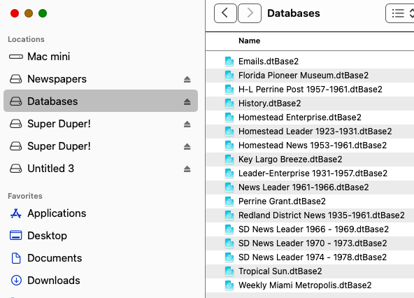

Here is a screenshot of what Finder sees:
When the issue happens, the partitions don’t disappear - the image of the files do. But the files are intact - see explanation below.
This image is of the older drive, that, before I removed two partitions, the images of the files in the partitions disappeared on a regular basis. I’ve been running now for 15 hours and the files are still visible. I wasn’t clear in my terminology: the partitions don’t disappear and the data remains intact. When this issue happens, all of the images of files in the right side of the screenshot from Finder disappear and DT can’t find them, so my work comes to a halt until I force quit the drive (the normal eject command does not work), power it down, turn the power back on again and then the files re-appear. DT is happy until the next time this happens.
To repeat: I removed two of the three partitions, leaving only the databases. Everything has been fine for 15 hours. Before I removed the partitions, this issue happened every couple of hours. I can’t see that this is a hardware issue as the data is intact. What is happening is that DT can no longer “see” the database files. I know this has happened when I can no longer access files in DT, move files from the Global Inbox to another group, etc.

Now that the situation has stabilized, I’ll turn on the other drive, which has a copy of the database, just to see how long it takes before it starts acting up. I’m not going to use that copy of the database, though - I’ll just take note of how long it takes to go to lala land and then I’ll post a screenshot of what Finder sees.
