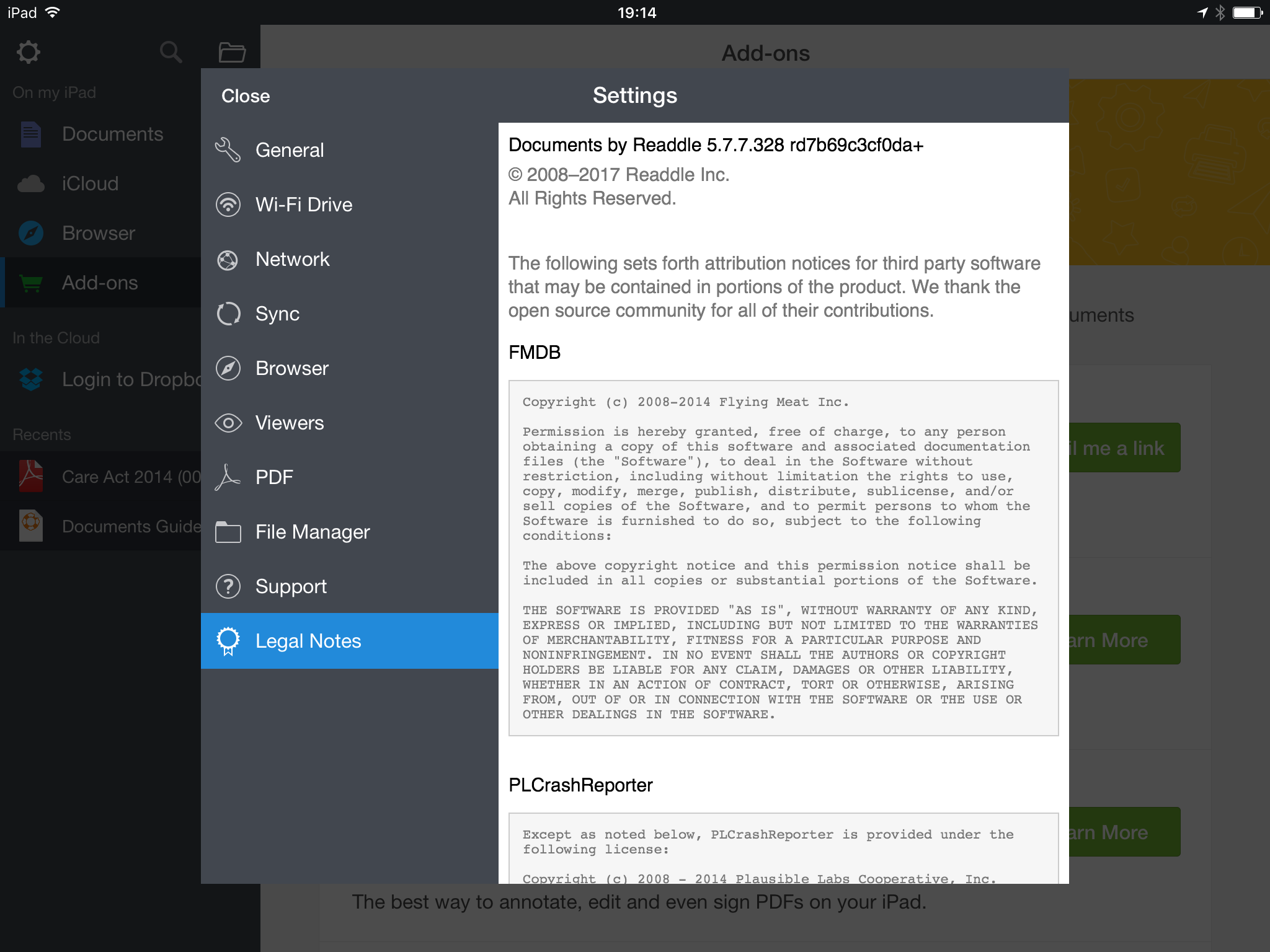

Okay, for the life of me I cannot find the thumbnail view icon, nor find reference to it in the manual.
Any ideas please? Have tried in both orientations, does my iPad being a Mini make a difference please?
Are we sure we are talking about the same app? That image doesn’t look like anything out of the iOS Documents.app by Readdle. Here is what I see when a PDF is viewed/edited in Documents.
Can only answer by posting this image, as your thought was one of the first I entertained, then dismissed.
OK, found it-never knew this option even existed. Go into Settings>PDF and see if you can change View PDF in from Built-in iOS Viewer to Readdle PDF Expert. If that is not an option, then you will still need to purchase PDF Expert. I have PDF Expert also, and it really is a good app-worth the money.
