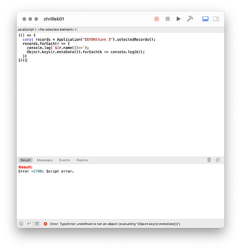

I then thought maybe I could modify the script to set these fields to "" and opened up the DT Library in Script Editor but could not find anything for Country, Administrative Area, Postal Code, and Locality.
I couldn’t find anything else in the forums when I searched for deleting Country, Administrative Area, Postal Code, and Locality, so I do appreciate any advice! Thanks in advance.
