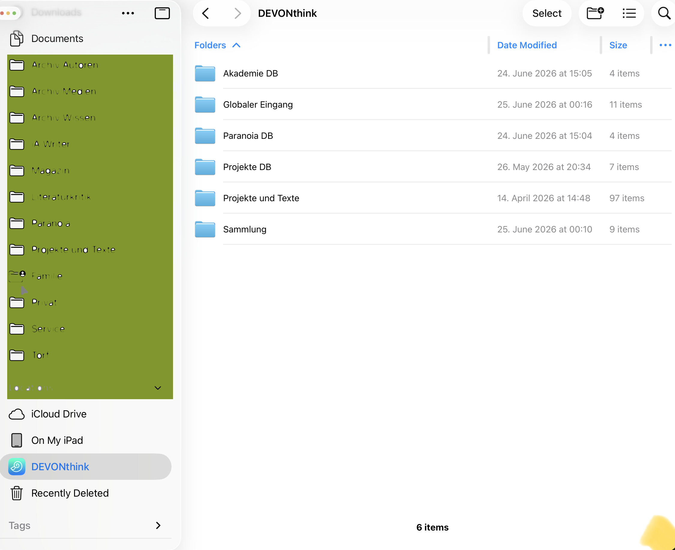

Deleted (and „cleared“) databases still shown in iPad files app
After a re-organisation of my databases which are synchronized between MacOS an iPadOS I have now 4 database folders which are shown in the iPad files app and I cannot get rid of them. They were cleared from the synchronisation process and are not shown in the iCloud sync panel anymore. How can I delete those undead „Flying Dutchmen“?

As I said: Several database folders are shown in the iPad Files app, and it es not possible to delete them. You can trust me that I know how to delete or move folders.

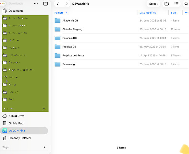

Four of them are old ones which I cannot delete and not even open. In DTTG they are not visible or recoverable.
Did you try deleting them from DEVONthink ToGo and not the iPad Files app? what happened when you tried?
I did not only try but succeded with deleting the databases from DTTG – AFTER I inactivated them from the iCloud (CloudKit) synchronization panel. Parallel I deleted and cleared the databases on the Mac. But as you can see on the screenshot, they are undead in the files app, with seemingly xx files as content. But I cannot open, move or delete them there.

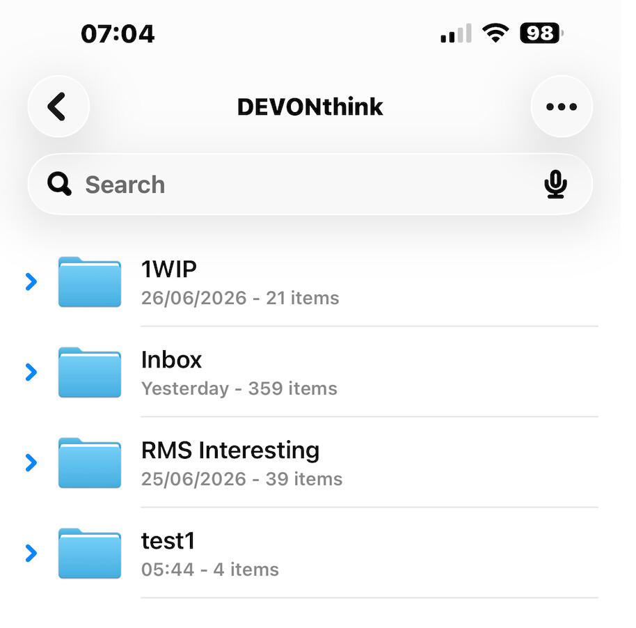

But Big Surprise. The first two had disappeared after having been there last evening. When disappeared, I don’t know, but it was about 10 hours overnight since the first test. Didn’t expect that. I wish I had looked before doing the repeat test.
My hunch is iOS took it’s own time to remove the folders that DEVONthink had deleted with the “delete”.
I then deleted the “test1” in DEVONthink. The “deleting database” with the squirrel (?) icon and blue bar seemed to get stuck. Dunno why. After letting it sit there for a few minutes, restarted DEVONthink ToGo. “test1” still shown in the DEVONthink ToGo Databases list. Then long-pressed to delete, and the database name instantly disappeared from the Database list.

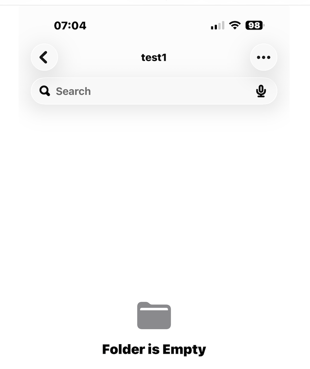

In Files, the “test1” folder still there. It says “four items”, but clicking into the folder shows “folder is empty”. So reported as not using space, but the root folder name remains.
I’ll check back at intervals today and see if I can see when iOS removes this folder – let’s call it a phantom folder.
As you say @BLUEFROG “non-fatal” and probably a non-problem as deleted database folder for me is empty and apparently not consuming space.
I suspect an iOS issue.
edit: screen shots showing the phantom “test1” still shown in Files. 4 items, but then clicking on the folder name shows the folder empty.
My screenshot shows numbers at the folders. since I can not open them I do not know if there really is any content.
The issue was persistent on my iPad for several days. After deleting DTTG from the device and reinstalling, the undead folders do not reappear. As rmschne has observed: They will reappear if I rearrange my databases again. IPadOS issue or DTTG issue, non-fatal or critical: I do not like such phenomena. It makes me distrustful and it consumes unnecessary time. Perhaps there is a life beyond DTTG.

In followup, this morning, the following day after the DEVONthink ToGo test database was created then deleted with DEVONthink ToGo “delete” function, I checked if the above “phantom” test1 folder still shown on iOS Files App. Launching a fresh copy on the iPhone, for a moment the folder name was visible then it quickly disappeared. Poof. Gone.
It might have been gone earlier in the cycle and the Files app just refreshed itself and not actually deleting the folder name just now.
So, it looks like iOS just takes its own time to remove the root folder of a deleted DEVONthink ToGo database. Dunno why.

On my iPad one of the Phantom Folders stayed for weeks, the other for several days. Only by deleting DTTG I could eliminate them. DTTG Test Flight 4.2 by the way.
