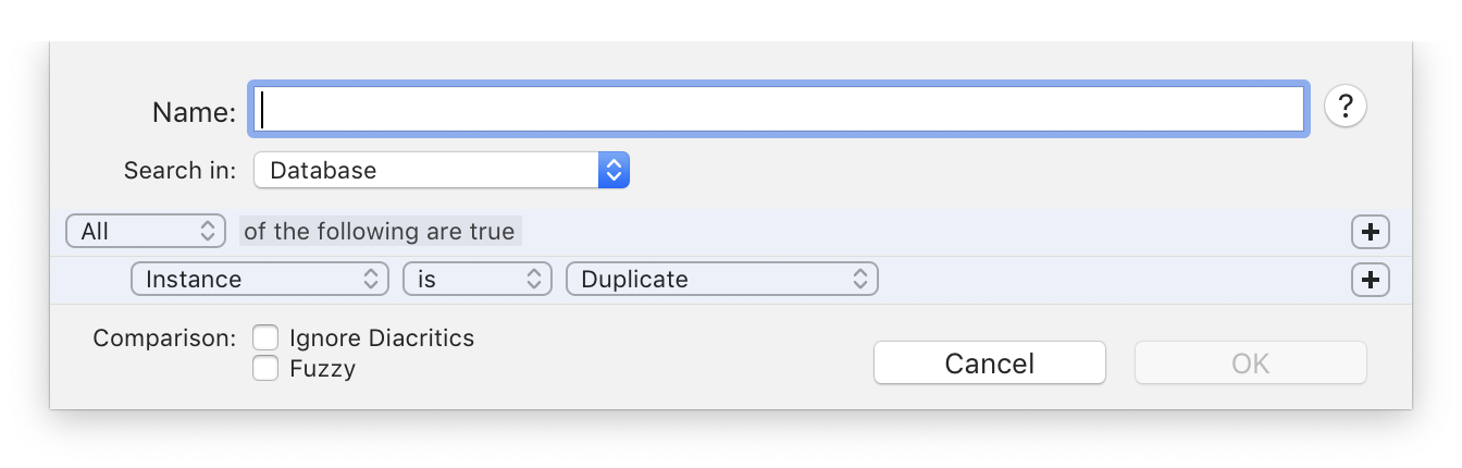

Every new user of DEVONthink has to begin somewhere. So. I’ve mistakenly included a duplicate of each new file I’ve entered. I’d like to clean up my database. Would someone please tell me, baby step by baby step, how to get rid of all these duplicates? Thanks for your patience.
Just create a smart group with the condition Instance is Duplicate. Afterwards select all results of the smart group and choose Scripts > Data > Move Duplicates to Trash.
Thank you for your prompt reply.
One of the challenges in using Devonthink is terminology with which I’m unfamiliar.
Am I correct that your word “condition” is synonymous with “operators and wildcards” when I create a smart group?
As you directed, I entered “Instance is Duplicate” in that space.

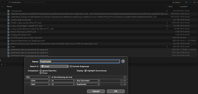

Criss, You show an example screen shot for a smart search for duplicate files. I’m trying to do the same thing, but “Instance” is not in the dropdown box you used. I’m using DT3b2. Has it been removed? Is there an alternative?
–Thanks
The former “Record” and “Instance” conditions have been merged, see “Item” condition.
It is not a complicated process to:
Search “Email” Group > Any of the following are true:
Kind is Any Document
Item is Duplicated >Ok

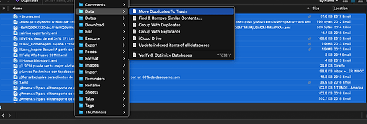

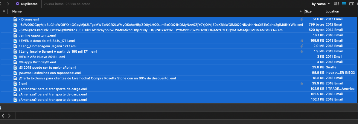

Select all the items that are shown as duplicates (I am assuming that the MDTT script will leave 1 of the items behind)
Scripts> Data>Move Duplicates To Trash

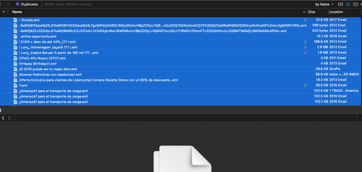

Could you please screenshots before/after executing the script? Thanks.
Hello. Thank you.
- Identify duplicates
- Select all duplicates
- Move duplicates to Trash
- After executing script. Same as starting point.

The conditions of the smart group are wrong. Most, maybe even all of the returned emails are not duplicates. This should be changed to “All”:
