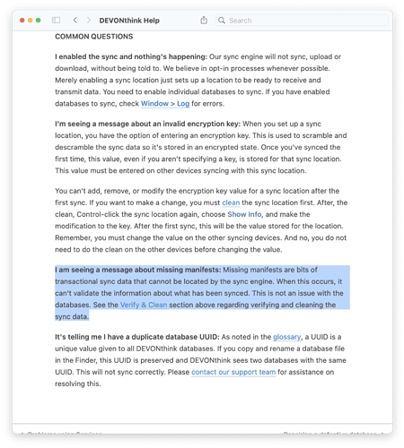

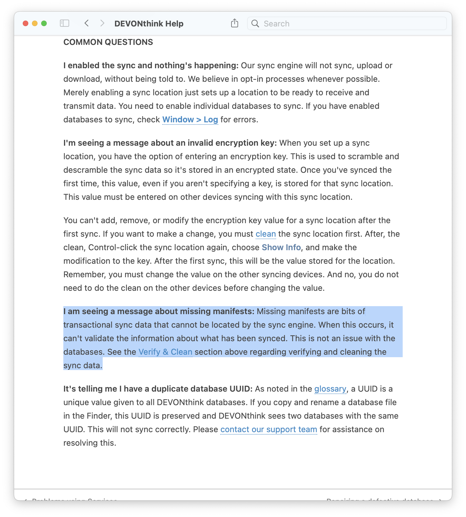

See the Troubleshooting > Sync Issues > Common Question section of the help and manual

See the Verify & Clean link in the Help I sent a screen capture of?
