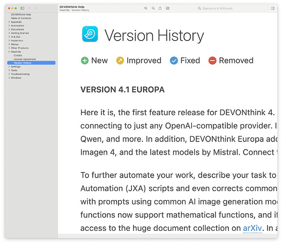

Zooming is available e.g. via the toolbar of the help viewer.

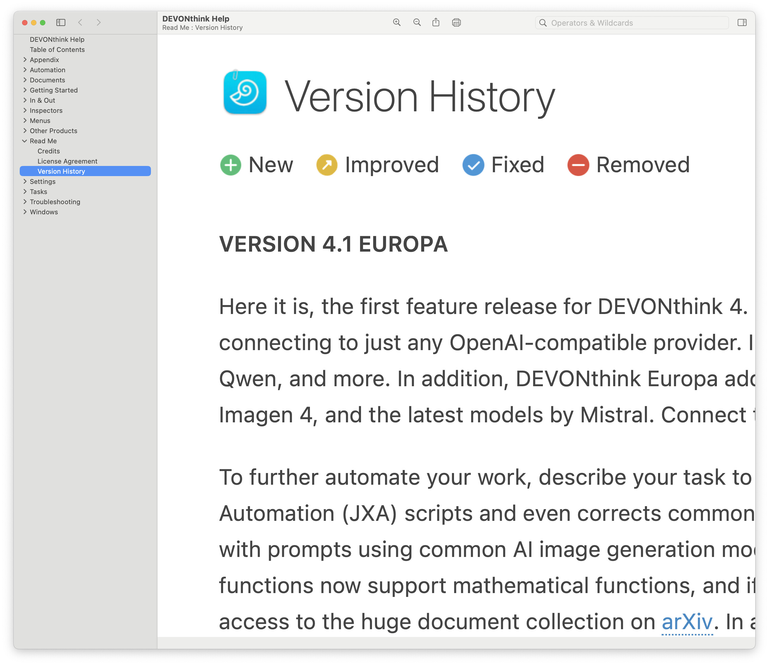

And you can also pinch to zoom in the Help too…
