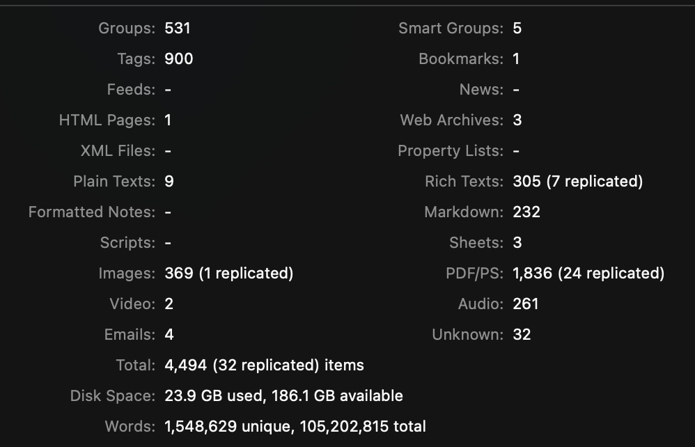

90 dollars? :open_mouth: How many items and tags do your databases contain?
Not that much, actually. See screenshot.
My mistake was to use Claude Opus with Max Effort. Total overkill.

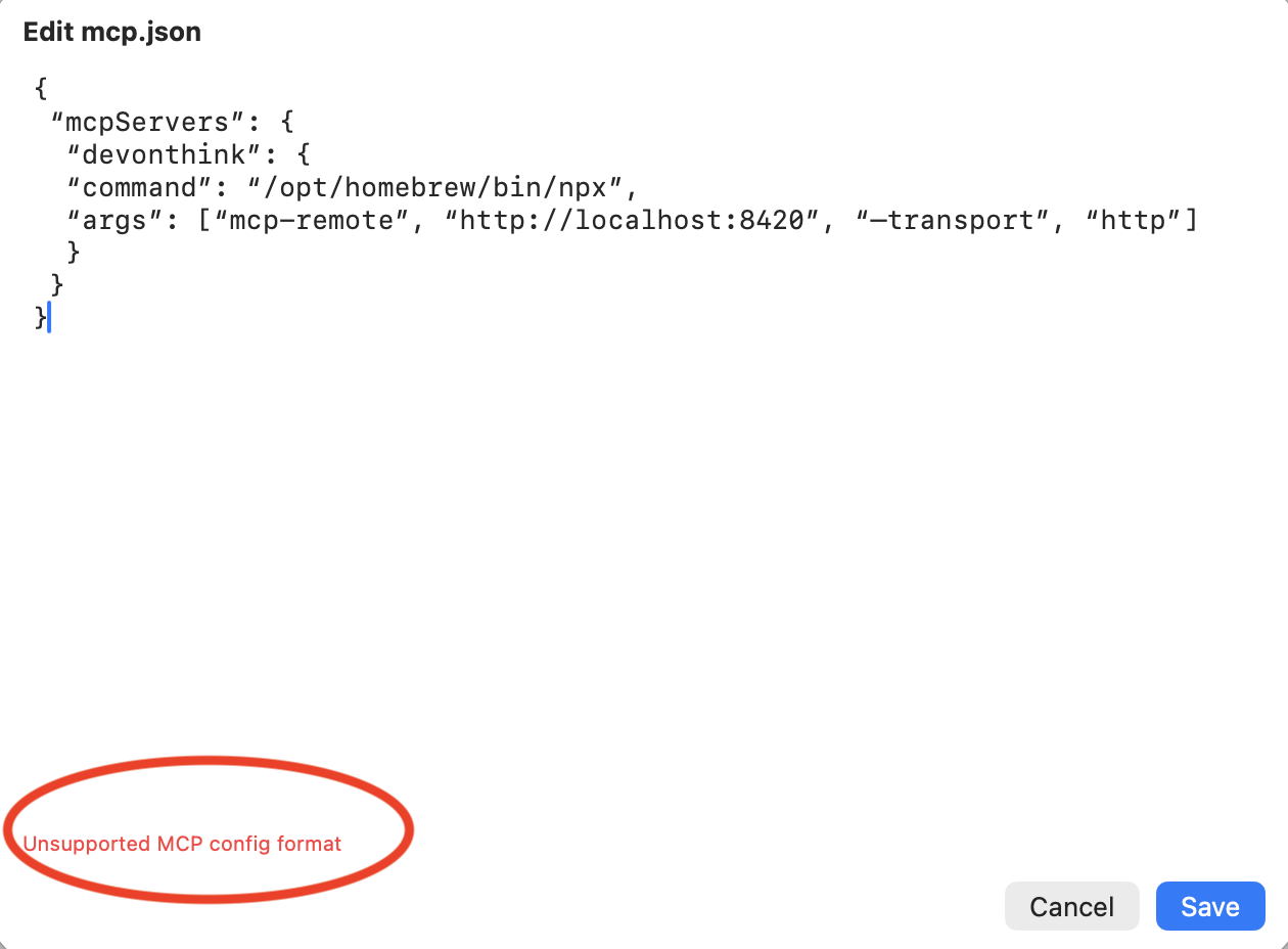

Maybe I’m doing something wrong or forgetting something, but in my case, I get an error when I try to save the script.
Can you paste the config here as text? I’ll check it.
Below the plain text:
“mcpServers”: {
“DEVONthink”: {
“command”: “/opt/homebrew/bin/npx”,
“args”: [“mcp-remote”, “http://localhost:8420”, “–transport”, “http”]
I must say that I have found the right solution by now. I also connected the DEVONthink MCP to Cloud Desktop, and then I imported the MCP server in Bold AI 2 by selecting the three dots in he upper right corner. This gave me the following configuration, which does work:
