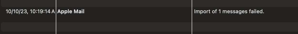

Hello,
FYI I also get an error[1] using the view/import mail.
If I quit DT and restart it, the import works
[1]
Is this part of your support ticket?
No the support ticket was on Clipping from Safari/Firefox … then I went into a tangent in this thread (my fault).
No problem. Can you open a new ticket on this issue so we can look at the current logs?
