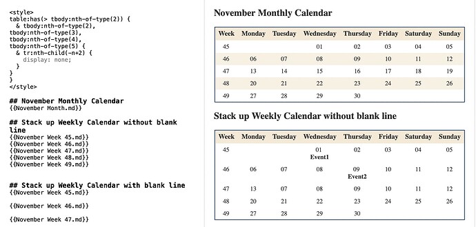

Well, it’s possible with CSS, at least for the case with no linefeeds between the transcluded files. One could come up with some CSS for the “with linefeeds” case, but it’s a lot more difficult: Without the headers, the table rows all have differing widths.
So, this seems to do the trick here:
<style>
table:has(> tbody:nth-of-type(2)) {
  & tbody:nth-of-type(-n+5):nth-of-type(n+2)) {
    & tr:nth-child(-n+2) {
      display: none;
</style>
That looks horrible, I know. But it seems to work in DT on Ventura, i.e. with a relatively recent WebKit. The CSS relies von the :has funciton to find those table elements having at lest two tbody children. That’s the case for the “no linefeeds” transclusion.
It then defines a rule for all tbody elements but the first one (tbody:nth-of-type(2)…tbody-nth-of-type(5)), namely to turn the display for their first two tr children off. Those are the pseudo headings and the useless :--: rows.
Here, & is the CSS nesting operator. It’s not strictyl necessary here, but I used it to break up the whole selector chain. Without &, it would look like this:
table:has(> tbody:nth-of-type(2)) tbody:nth-of-type(-n+5):nth-of-type(n+2) tr:nth-child(-n+2) {
      display: none;
(The image is from an earlier version of the CSS)
Making every second row in that condensed view stand out is left as an exercise for the reader :wink:
