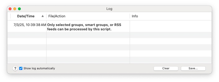

which worked as intended mere days ago. But when I tried to use it today, DT’s log window says
Only groups or local smart groups can be processed by this script.
I tried using the script in four combinations: when a (regular group / local smart group) is (selected / opened in a window). According to the descriptions of the script, all four scenarios are supported, but during my tests all four resulted in the same log message above.
Here are the things I tried:
  1. I re-downloaded the script from the location in the screenshot above. The log message stayed the same for all four combinations.
  2. I duplicated the script file in Finder, and modified the log message in the duplicate so that it’ll output the selectionType after the plain text: log message "Only groups or local smart groups can be processed by this script." & selectionType, but the selectionType in the log message doesn’t make sense to me: «constant ****DTsg» .
I don’t know how to debug the script further, and I’d appreciate it if you could provide some advice or insight! Is this a bug in the script or did I mess up something on my local machine?

As I mentioned in the main post, the AppleScript above is a modified version of the script downloaded from within DT, and the only modification I made was the added selectionType after the log message “Only groups or local…”.
Does it work after selecting a group in the item list?
Hello Christian, I busted tested it for the first time, using the same regular group and the script that was slightly modified by me. Here is the output in the log window:
Only groups or local smart groups can be processed by this script.«constant ********»
