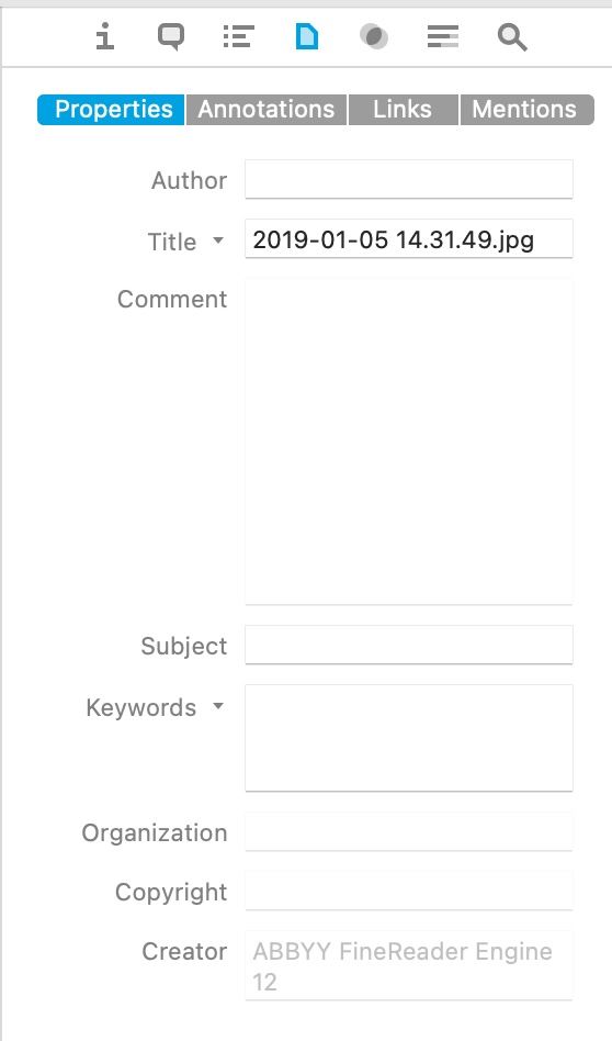

The final PDF size can be dependant on whether the file has to be modified after OCR. This can happen when the original document contains annotations or other metadata that need to be transferred to the PDF generated by the OCR. These changes are saved using Apple’s PDFKit which does not provide the same level of compression as ABBYY.
One way to check this is to select the PDF document, open the Document Properties in the Inspector and look at the Creator Field. If the Creator is macOS Version xx.xx Quartz PDFContent the content was resaved after OCR otherwise it will show ABBYY FineReader Engine as below.
