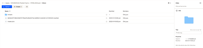

I have been experiencing an ongoing sync issue the past few days with Dropbox. I have been getting periodic notifications that 8 files in Dropbox were added when I was not using DT. I am new to DT, so I did not catch on that it was an error until today. I am experiencing/seeing the following things:
In the primary DT folder within DB, there is a sub-folder called “inbox.” There are several files that are showing in this folder but do not exist in my Global inbox. When I try to delete the files after a short time, they duplicate into the same sub-folder.
In the Dropbox trash, there are 100s of files that have been deleted every few minutes. It does not appear I have lost any data. It seems the files are duplicating and deleting themselves in a cycle.
My most recent database will not show on the DTTG app.
Please let me know if you have any suggestions to troubleshoot. I provide a few screenshots below.

Thanks. I’ve not seen that reported before; manifest files are part of the sync stream, so that much makes sense. Do you have any smart rules acting on your global inbox which might be repeatedly doing something to the files there? Presumably you are good for space on DB? I don’t use Dropbox for sync myself, so I think we may have to wait for others to weigh in.

Thank you. I followed each of the suggested steps except #4. Before starting step #3, I checked Dropbox, and the DEVONthink folder was cleared out. After resyncing, I went back into Dropbox to check the folders, and it reverted back the exactly the same state. The inbox folder shows files that do not exist again-including the receipt folder. Do you think I should create a new connection with Dropbox?
