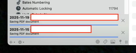

I have had some scans today work fine but also some that get permanently ‘stuck’:

In DEVONthink, hold the Option key and select Help > Report Bug. In this instance, do NOT send the email. Copy the content and attach the logs when you respond to this ticket. For unrelated future inquires and reports, use this mechanism to open support tickets, sending the email to the default email address.

Hi - I will do the next time it happens. It turned out that after I cancelled those 2 actions, the documents ended up in DEVONthink anyway. It had worked perfectly just a few minutes earlier and afterward I got a USB communication error so I have removed/readded the printer’s USB connection to my Mac.
