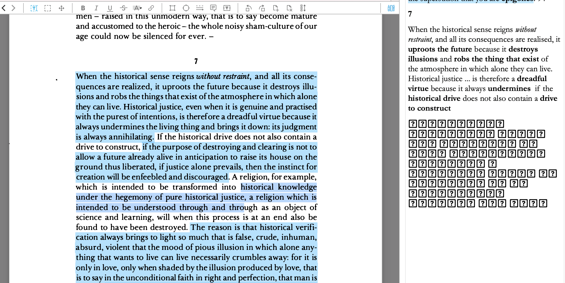

I have been using Devonthink for a few months, so I am still relatively new to it. For the second or third time now, I am experiencing the following problem – text from a book pdf that, yesterday, used to lend itself to being copied and pasted into the annotations box, is today not identified as recognisable text at all by DT. When I try to copy and paste bits of text, all I get into the annotations box are a bunch of question marks (see screenshot below).
It also turns out that the text in this particular pdf isn’t even searchable any more (this used to work fine before). The other pdf’s in my library don’t have this problem, so far as I can tell - but it is still frustrating, especially since, as I said, it’s not the first time it’s happened.

Which version of macOS do you use? Depending on the PDF document and its internal structure & encoding the PDFkit of macOS might sometimes corrupt the text layer unfortunately.

It’s Big Sur 11.5.2. This sounds like it could well be the root of the problem - since, as I just found out, other software such as Acrobat Reader also don’t seem to identify text in the PDF. Shame!
I’ve had this problem intermittently throughout the years, too - it’s a pain. As far as I can tell from my experience, it happens with other apps, too, not just DT. The only solution I’ve found is to export the PDF to an image file and then re-do OCR. You lose your highlights and bookmarks/ table of contents but get the text layer back.
Re-applying OCR has never worked for me (at least in Acrobat). There’s some anecdotal articles online to similar effect, eg this one. My guess is that it’s something to do with the fonts in the OCR layer. SW
I tried running OCR in DT, which interestingly did change the text layer but didn’t solve the problem, I guess because the data has been corrupted.

As @BLUEFROG said, yes, it is one of the Apple PDF kit issues. I have perfectly valid PDFs that I can see in Windows, iOS and macOS with 3rd party apps (like PDF Expert, GoodReader or PDF Viewer from PSPDFKIT) but not with native macOS preview or any other application that use that framework.
Your last resort could be installing a ghostscript-like virtual printer, print the PDF into full graphic and then OCR it with DT or another tool. I don’t know any virtual printer for macOS, but you could use Windows 10 native “Print to PDF” to do it if you have access to a Windows 10 machine (virtual or real).
