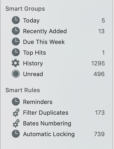

The first time I ran DT3 after installing the beta yesterday, I could have sworn it was populated with a default set of smart groups and smart rules. However, the second time I launched DT3, it replaced those default groups and rules with the ones I had in DT2.
Is my memory deceiving me or did those default groups/rules exist? Is there any way to get them back without a complete reinstall? Or to prevent a fresh DT3 install from replacing them with what’s already in DT2?
Some of them piqued my interest because they dealt with some of the new features, and I’d like to see what they did.
Yes, on the same macOS user account, but I am not sharing databases between them.
And I realize that smart rules are new to DT3. All of the default smart rules were cleared on the second launch so that all I have now are the smart folders from my DT2 install and no smart rules.
I have the same problem here… after opening my DT2 database in DT3beta, all smart rules of DT3beta disappeared (none of them in your screenshot is visible anymore), and the smart groups changed to those that I had in DT2. How to fix this? Why does DT3beta clear all smart rules?

DT3 is picking up the Global smart groups from DT2, likely by design as it would be transitioning from 2 to 3 when someone upgrades. So technically, it’s not a problem, but more likely intended behavior.
Again, another reason why I keep repeating it’s best to use a separate user account and test data for testing. This is a beta test.
The other option would be to just convert to DT3, however it’s not something I would advocate but many people have (including two of our most long-standing users in these forums).
If I had anything to say about it, I’d uninstall DT3 and install it afresh on a new user account.
