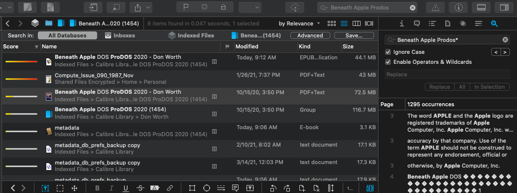

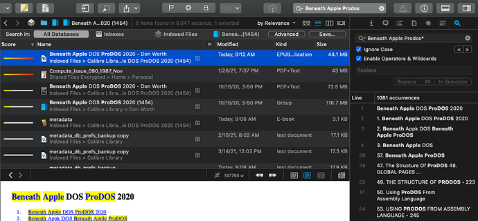

I think I tried the same process you were describing. I searched for my largest ePub (which is only 44 MB), single clicked to select the result, and DT completely froze up (spinning beachball) for ~10 seconds before rendering and showing the search results in the sidebar (1081 occurrences).
If I single click on the PDF version (73 MB), it takes about 10 seconds for all the occurrences to appear, but I can navigate the PDF, and watch the results building (eventually 1295 occurrences, not sure why the discrepancy, probably related to the conversion).
Single clicking back on the ePub again freezes DT up for about 10 seconds.
