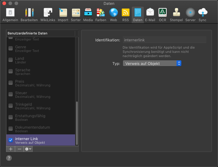

I did not test this by now but I think you could use custom metadata for this. From the help:
  • URL: Accepts any valid URL, including filesystem URLs.
  • Link: A special dropdown that allows you to choose an item in your databases. a link for the chosen item is used.
If you choose to use the URL type you’ll have to copy the item link manually and paste it in the destinations custom metadata (I think).
If you choose Link you’ll be presented all your data to choose from (I think).
You have to set up the metadata of your choice in Preferences → Data (Daten in german)
Then you’ll find the new custom metadata in the sub-tab next to “General” in the Inspector. There you can link to another record.
2019-05-12_11-01-43
To open the linked record either use the drop down menu or the normal menu item “Show in database” (in Datenbank zeigen in german) which opens the linked record if the tab is visible in inspector.
It’s also possible to link without using the inspector but you first have to add the new custom metadata to the columns menu (right click any column, choose “Customize metadata” (Metadaten anpassen in german) then in the next sheet you’ll find your new one at the bottom).
After that you can add a new column for your custom metadata. In case you’ve set up a Link metadata type you can now choose your link destination directly in this column. I like that :smiley:

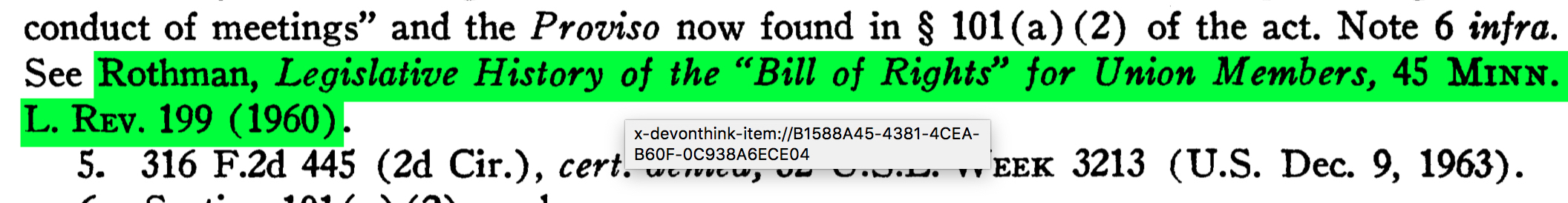

This is possibly not precisely what you are after, but one option would be to use the “Add link” contextual menu.
I have a particular highlight colour that I only use to indicate text that I want associated/linked with other files. As in the screengrab below, I have highlighted an article that I have in green, and have selected the “Add link” with that text still selected. In the background, I have “Copied item link” of that PDF article, which I then paste in as the “link” over in the initial PDF.
That entire green highlight is now a live-link to the related PDF. Clicking on it, takes me directly to it – but then my view is switched. Right+clicking it, brings up the contextual menu, which (at the top) allows me to select that PDF opening in a new tab, or in a new window/instance.
This doesn’t do what you want exactly, in that one wouldn’t see any reference to that link (or others) over in the Inspector window – but if this is something you do frequently, then presumably getting into the habit of doing it two the first word on the first page of every PDF – or some other consistent ‘spot’ inside your PDFs – would allow one to quickly get used to checking the document to ‘see’ if there is a link to another document…
