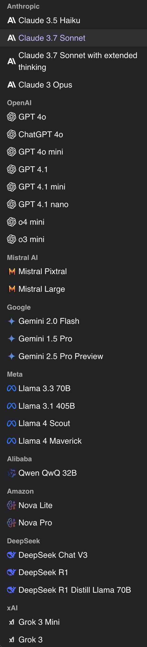

To be clear. The API key Kagi provide uses a mix of Ai models to power summarisation.
The place where Kagi provides real Ai value is with regard to what they call their Ai Assistant. This is a powerful desk research tool in the sense that it allows one to query multiple Ai services as part of a single research session, and those queries are tuned with real time search results from Kagi’s excellent search algorithm. These are the current models you can interchangeably use (apologies for the forum enforced image resize, instead view it here - Screenshot 2025-04-17 at 07.30.29.png - Droplr):
Good to know. Thanks for the additional information!
