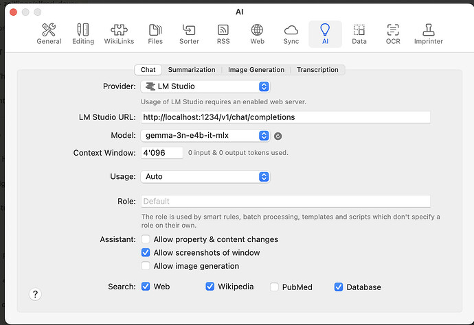

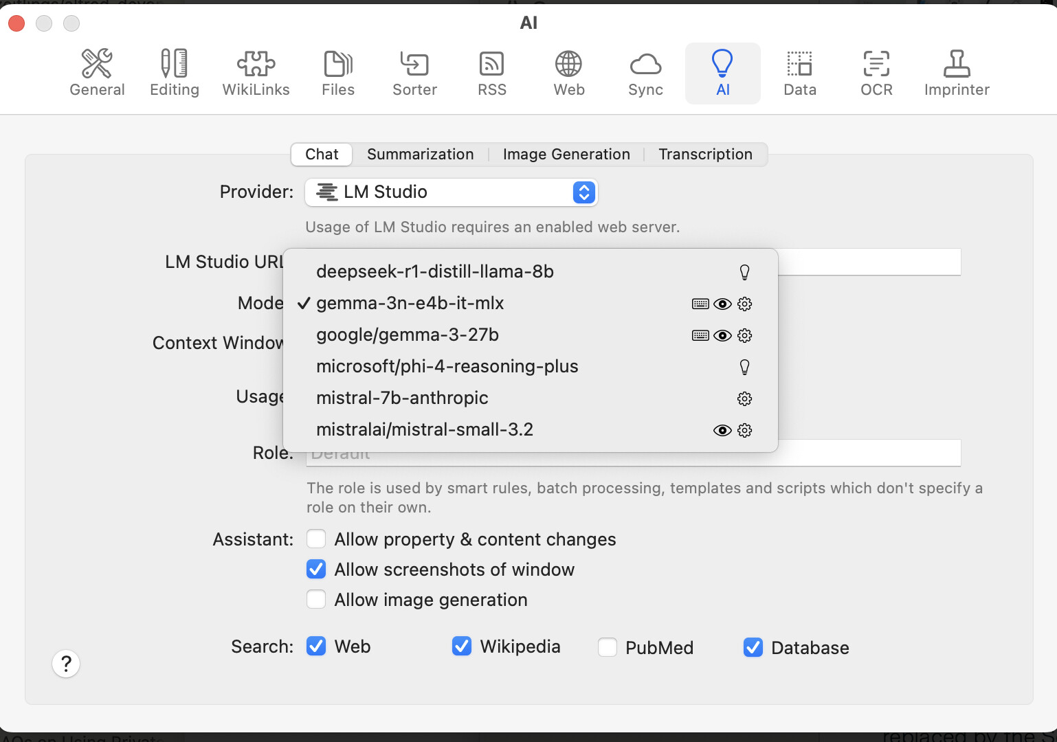

I have tried it now with a new Gamma 3n, but it’s still grayed out. Same for google/gemma-3-27b. If I switch to ChatGPT for example, the AI button becomes available. I am on a MacBook Air M4 32 GB, 15.5., DT 4.0.1
A screenshot of the Models popup in Settings > AI > Chat would be useful, thanks.

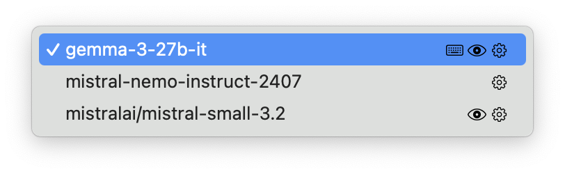

Thanks! A screenshot showing the opened Model popup would be great too.
The search assistant should be available for both Gemma 3 models on your screenshot actually, e.g. I just tried it successfully although using a slightly different version of Gemma 3:

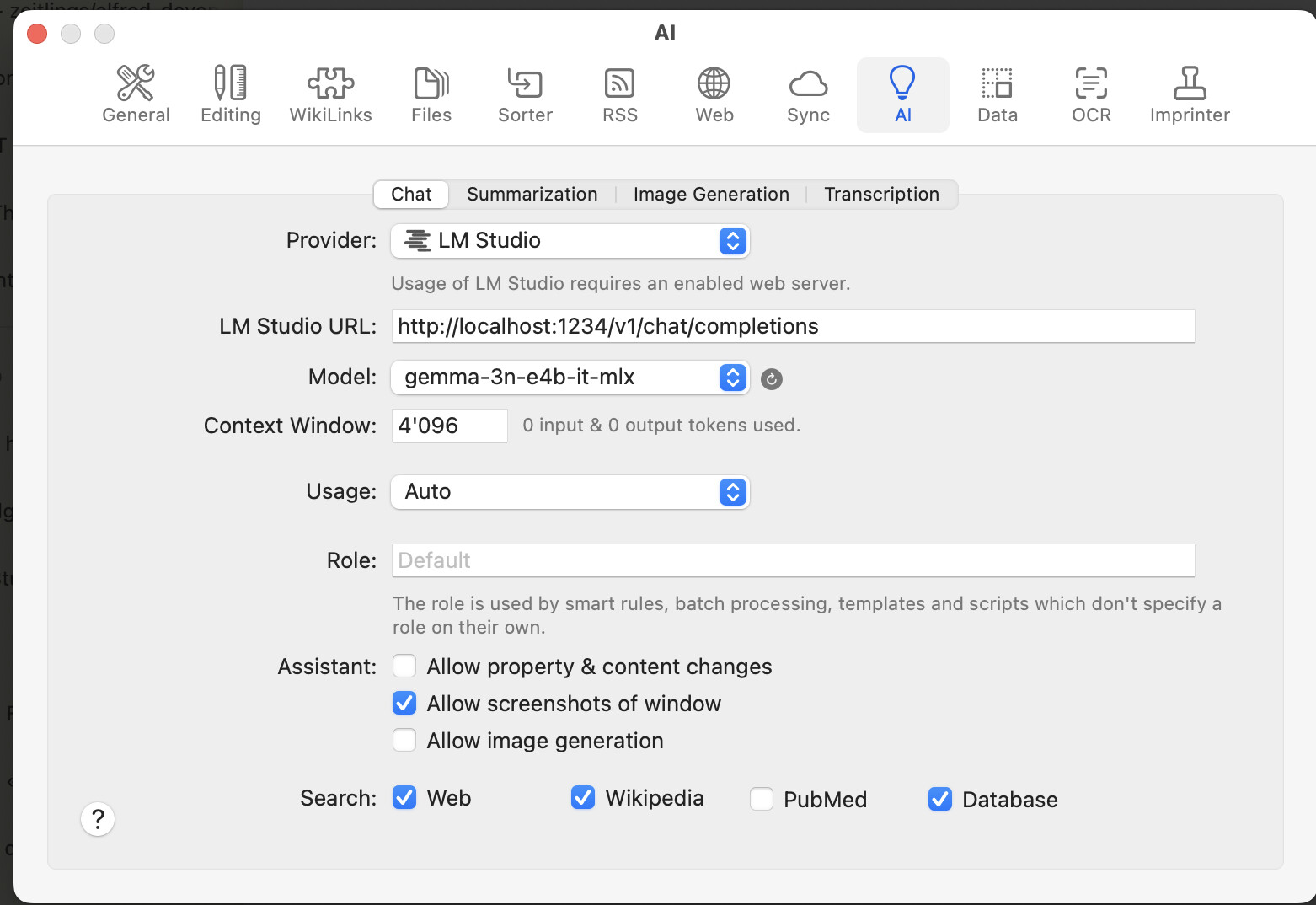

Grayed out with me. Anything else I need to adjust in settings?
Forgot to mention that a context window of at least 8k tokens is required, I’m sorry. In case of LM Studio this has to be changed both in DEVONthink’s settings and in LM Studio’s model settings.
Have you activated the option to allow external access in LM Studio? I don’t have it just now, but if you don’t enable it (and have it running) the Model window is grayed.
