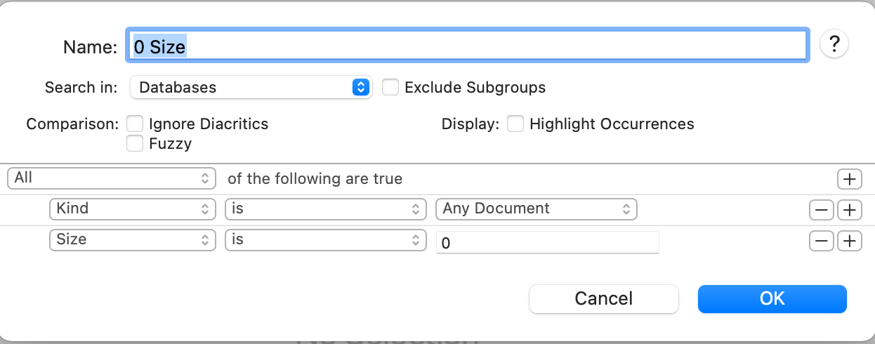

Hi, could you please let me know how to create such a smart group? I’m unfamiliar with it, tried it out but for one reason or another I only end up with smart groups for one database. Also they don’t show the 0-byte files in my database (which I do have now, unfortunately)

I suspect you have a database selected in the left Navigation side panel when creating this Smart Group. Put the cursor down in the Smart Groups area, then create the Smart Group. (Same thing happened to me).
Thanks a lot @rmschne!

Note Search in: Databases, which you will only be able to set when setting up a global smart group (by, quoting @rmschne, ā€œputting the cursor down in the Smart Groups area, then creating the Smart Groupā€)
