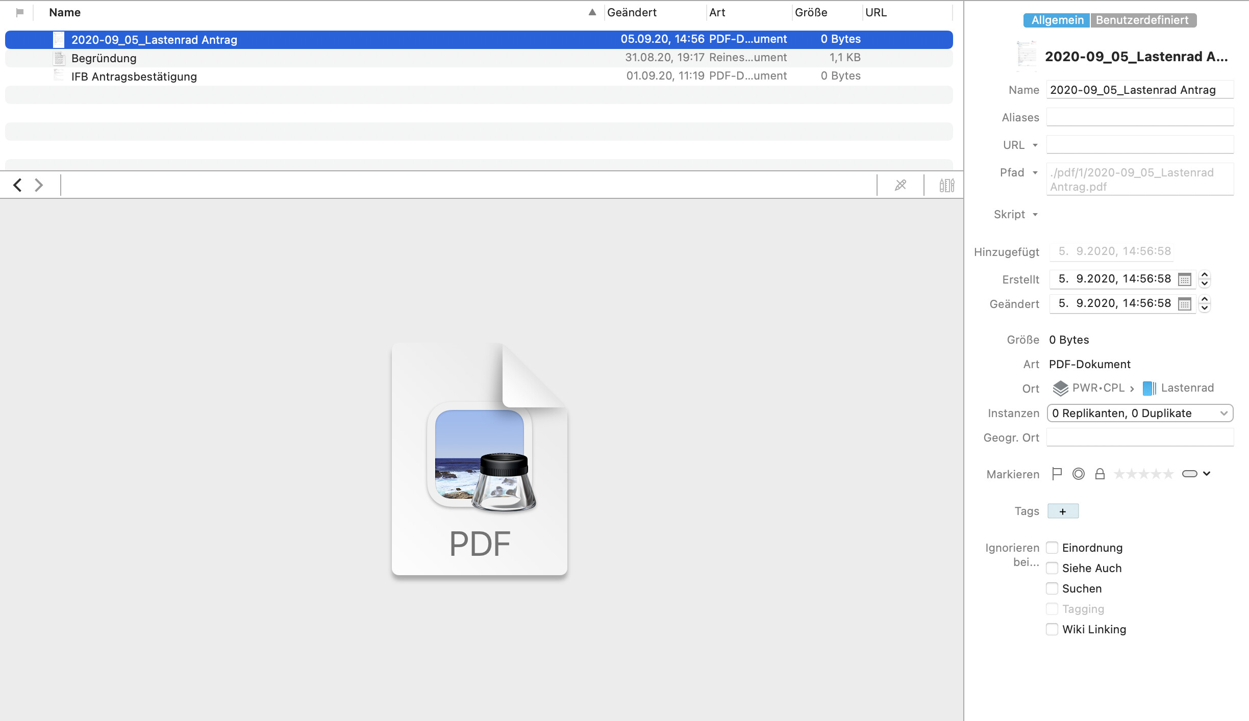

Thanks again. The thing is: when creating a smart group from the menu, it shows the option databases (plural) but after creating such a smart group, it reverts to database (singular). So indeed the only way I could create this database was pointing to the smart groups, and then use the contextual menu. Now I see all my corrupted files (I hope). Not many, thank God, but it does affect markdown and movie files too. They were created from October 2019 on, and most of them I haven’t opened (let alone moved) in many months.

Can you remember how they were created? And presumably you have synced your Mac with DTTG3?

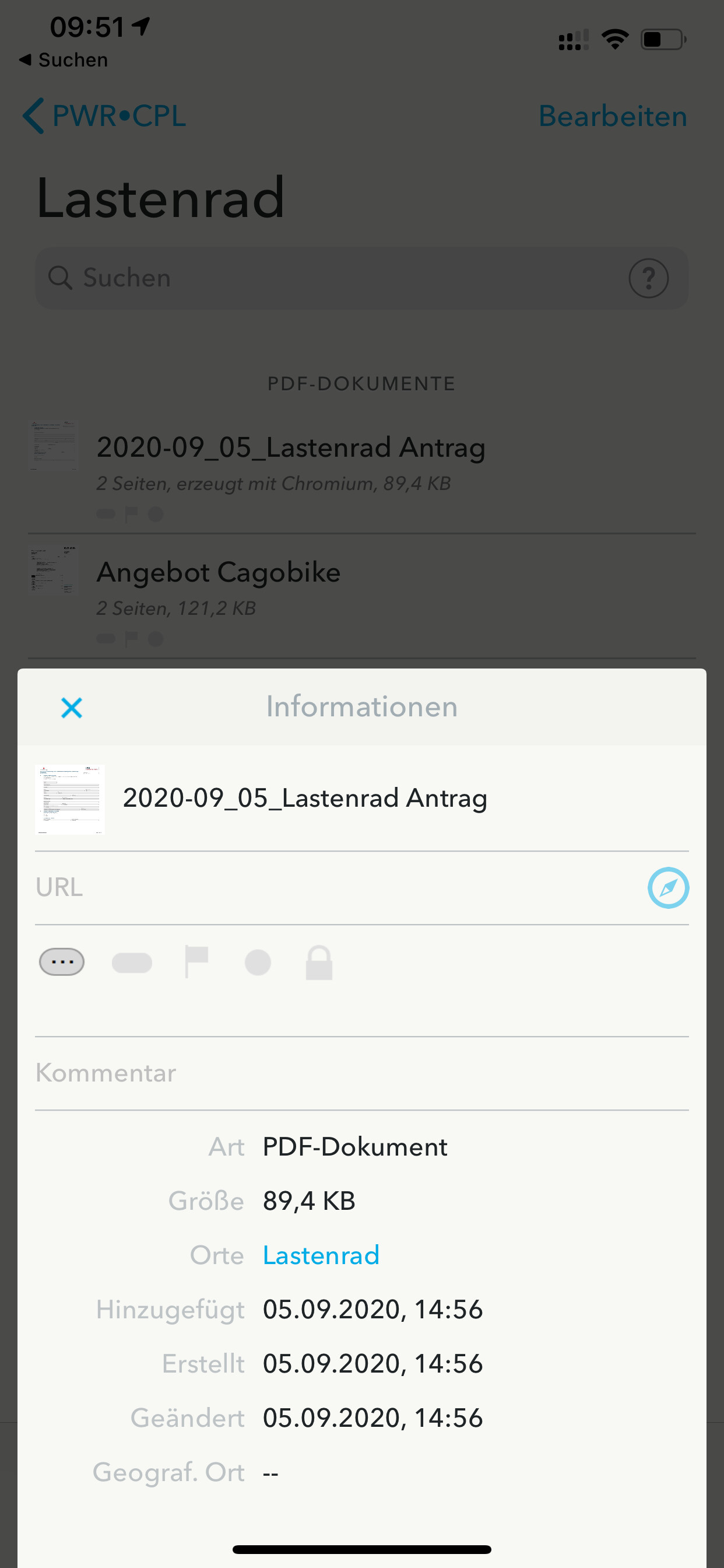

However neither the iOS or iPadOS version will let me sync. When I try to sync in DTTG I see an error in the log which says “Global Inbox: Failed database verification, please repair the database”.

@eboehnisch would have to comment, but that may be what is meant by this sentence in the change-log: “This update detects these files, shows them in a Ghosts smart group, and stops synchronizing the database.” I suspect the database will not sync until the 0-size file has been removed from the iOS device (that is trashed and the trash emptied). I’m not sure what will then happen to the file on the Mac - it may also be deleted on sync, such that you would then have to put it back from the backup once more.

In the DTTG 2 instances I can access all these identified files! (The sync was disabled through the upgrade process to DTTG 3 I think.)
