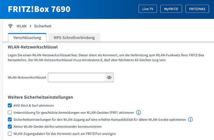

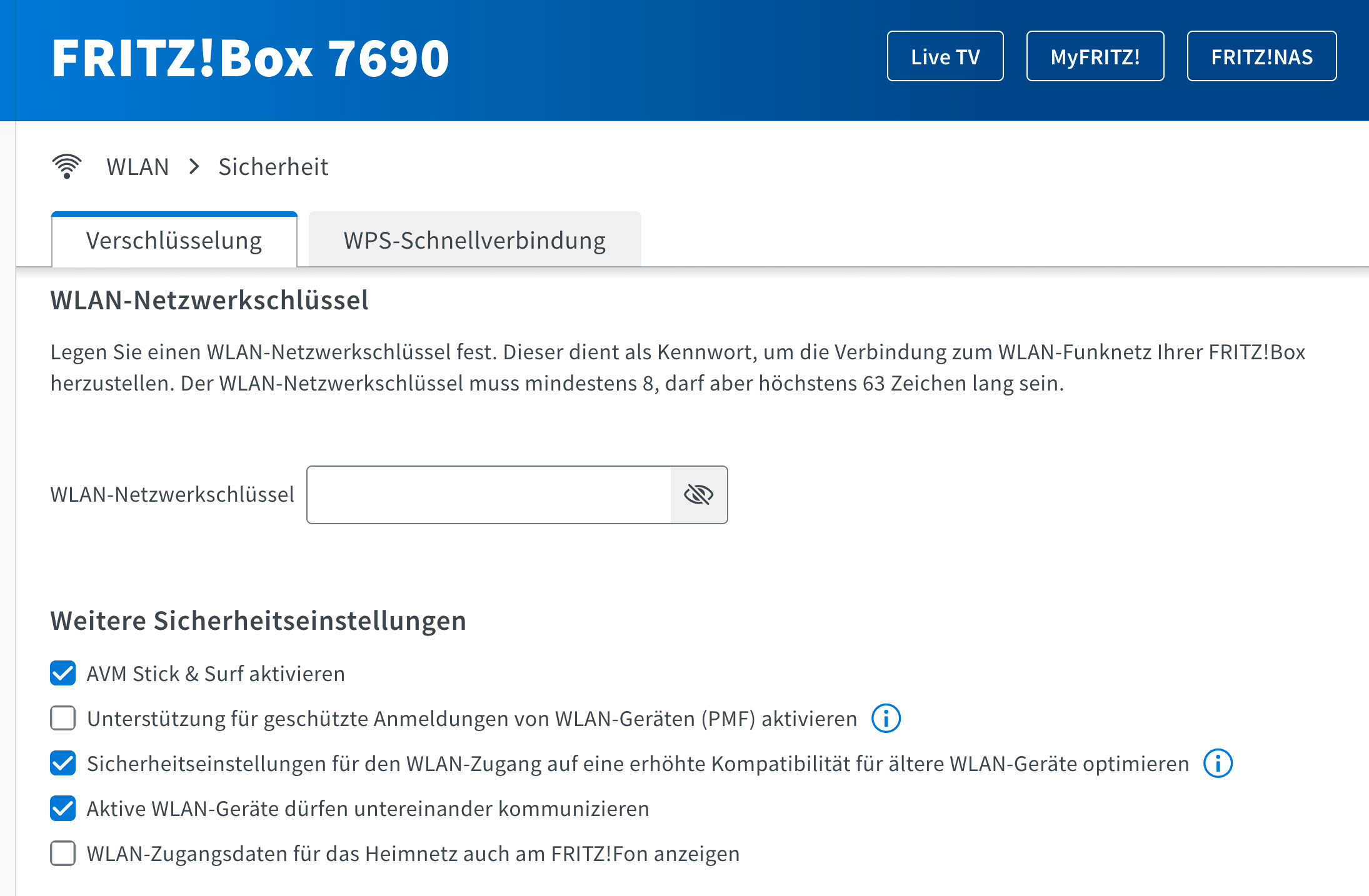

Did you turn on „devices on WLAN are allowed to communicate" in the FB?
