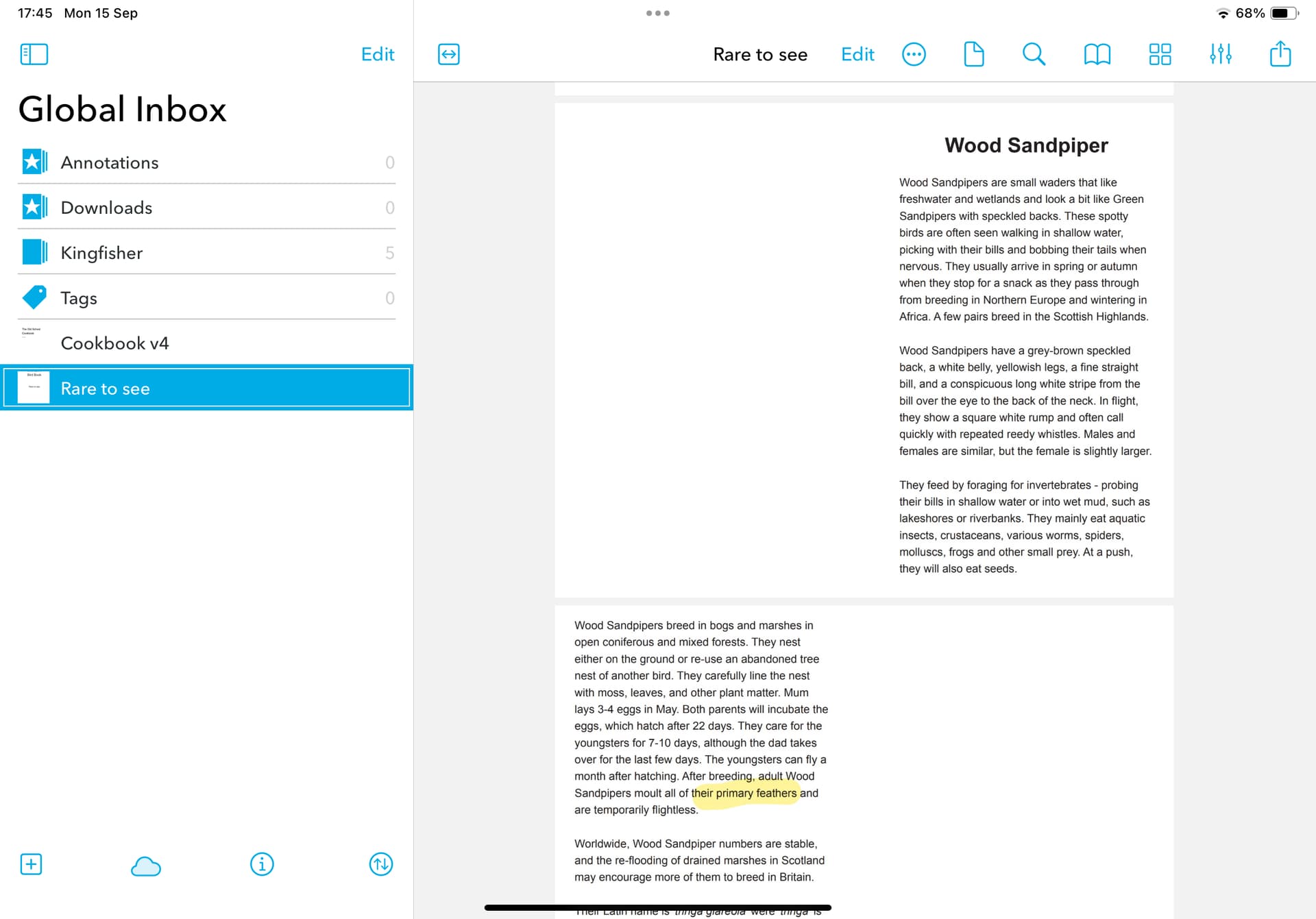

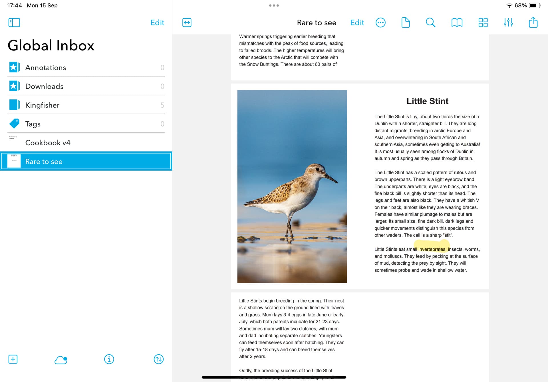

A couple of screen shots to show what happens.
PDF position in DTTG:

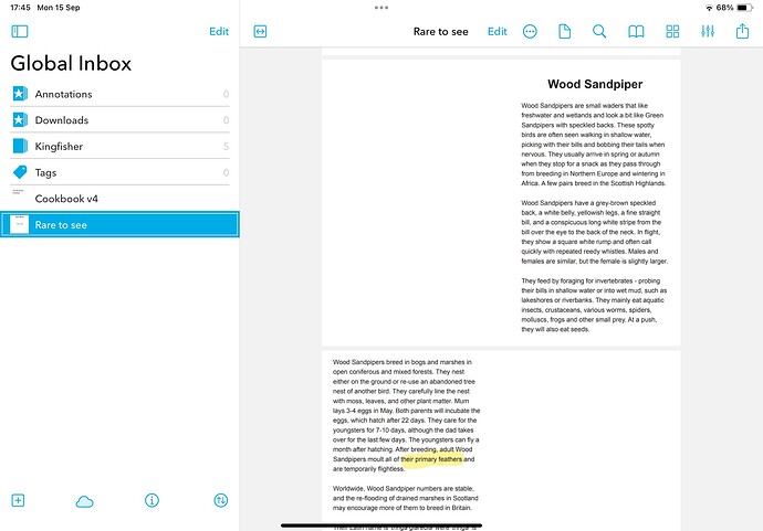

When switch back from Scrivener:
This is about 4 pages further on. I have noticed it only happens if the left hand navigation column is showing. If I make PDF ‘full screen’ it keeps position.
