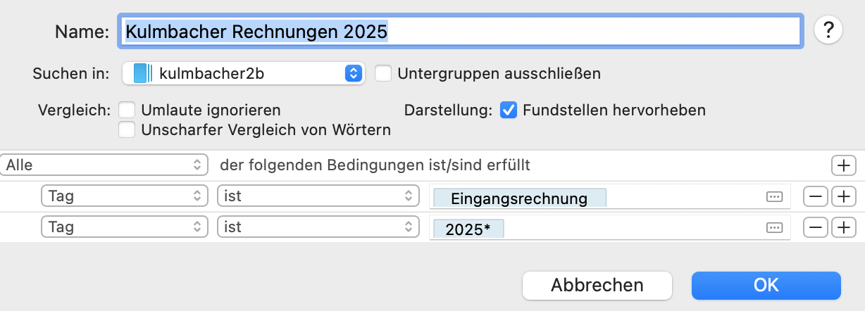

In DT Desktop (latest version) I have set up a group, an inside that group is a smart group. The smart group filters for tags inside the group, in my case “2025” and “Invoice”. That works and shows me 24 files. (see screenhot 1).
Screenshot 1

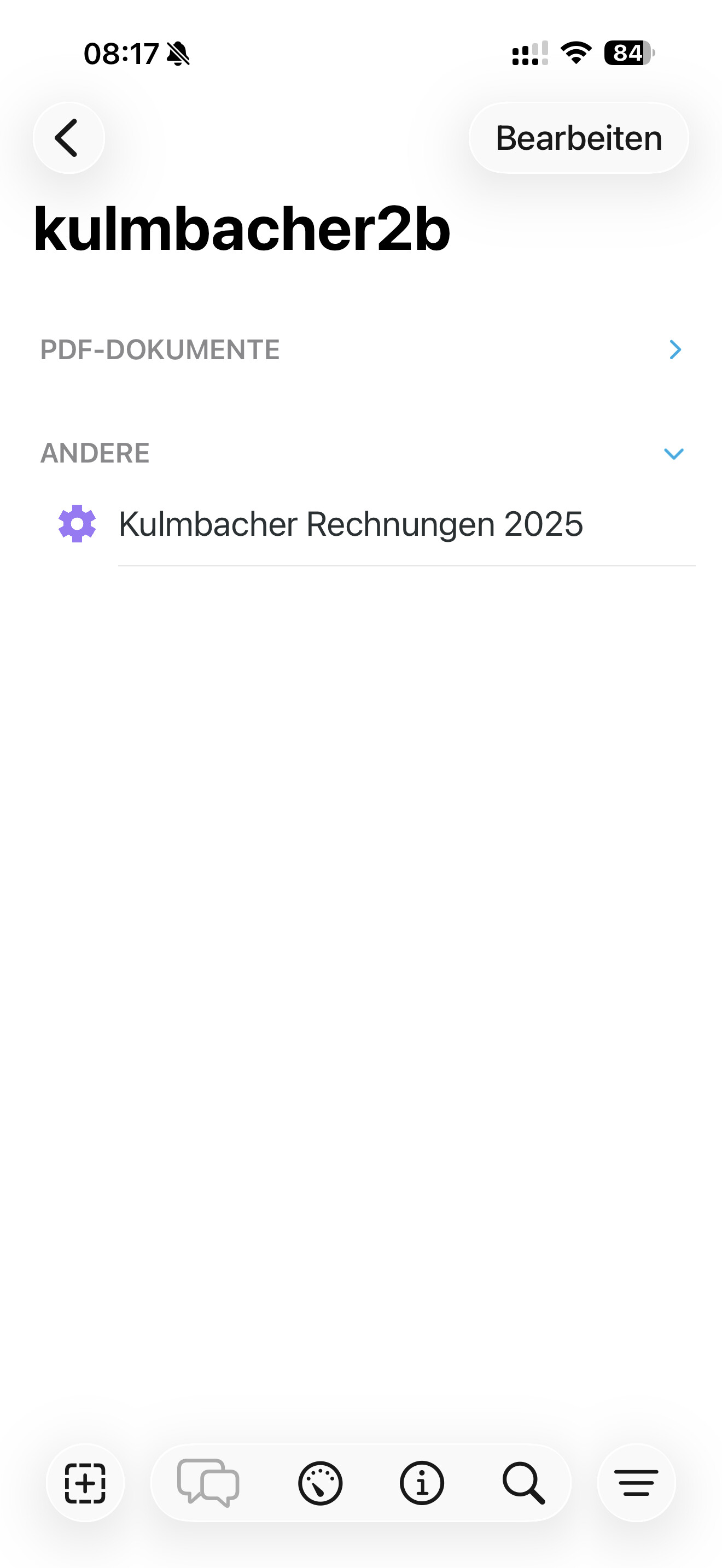

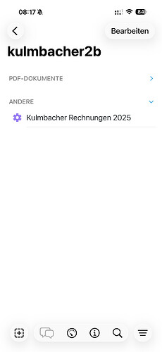

I navigate to my group, select it and it shows the following:

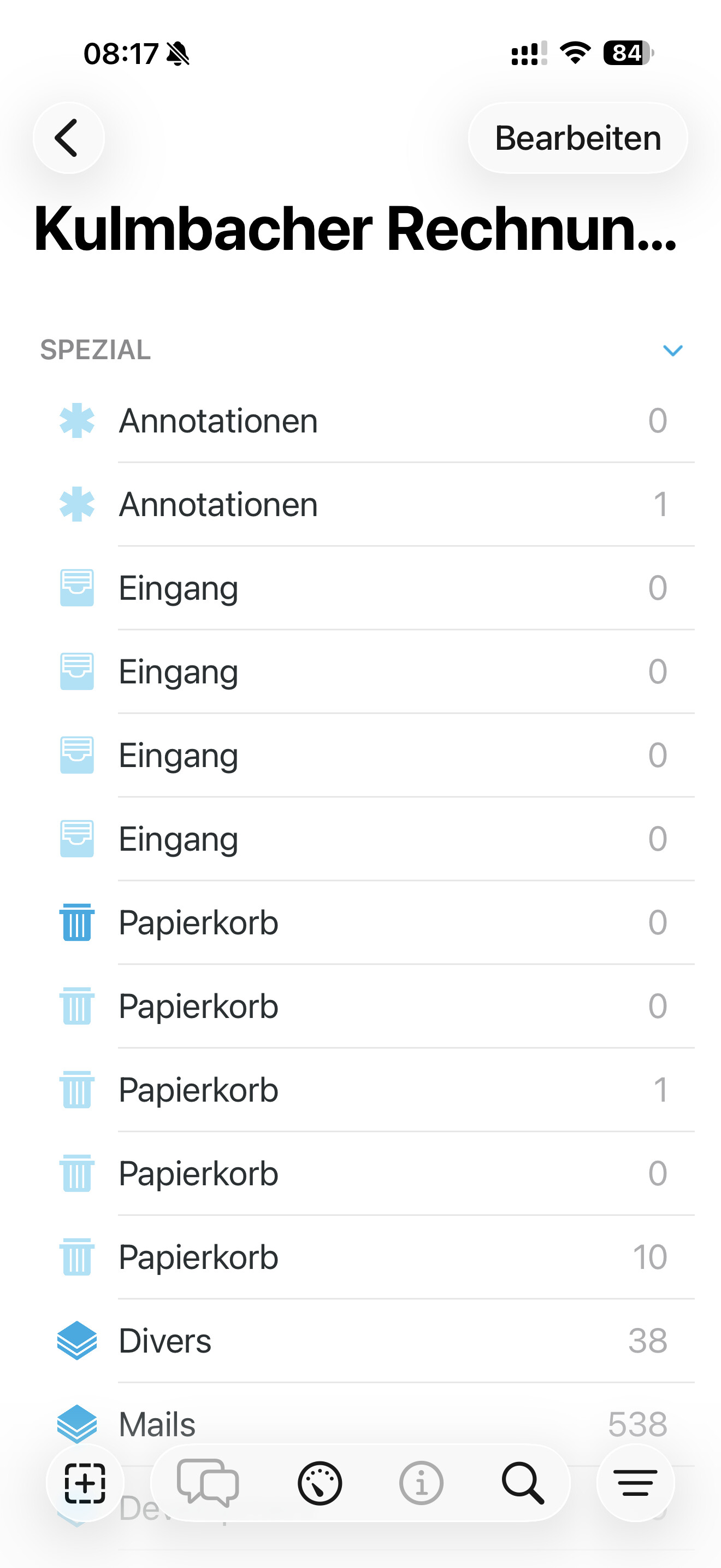

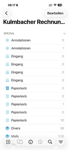

That is expected, what is not expected ist what is displayed when I tap the smart group “Kulmbacher Rechnungen 2025”. Instead of displaying the 25 documents, it looks like this:
That goes on an on, every item in DT is listed there, seems to me the scope of the search inside the group is not honoured?

Could you let us know what the exact criteria for the smart group were? We might need to adjust here a bit as outside our labs people use smart groups maybe in different ways and not all might be supported (or possible to support) in DEVONthink To Go.

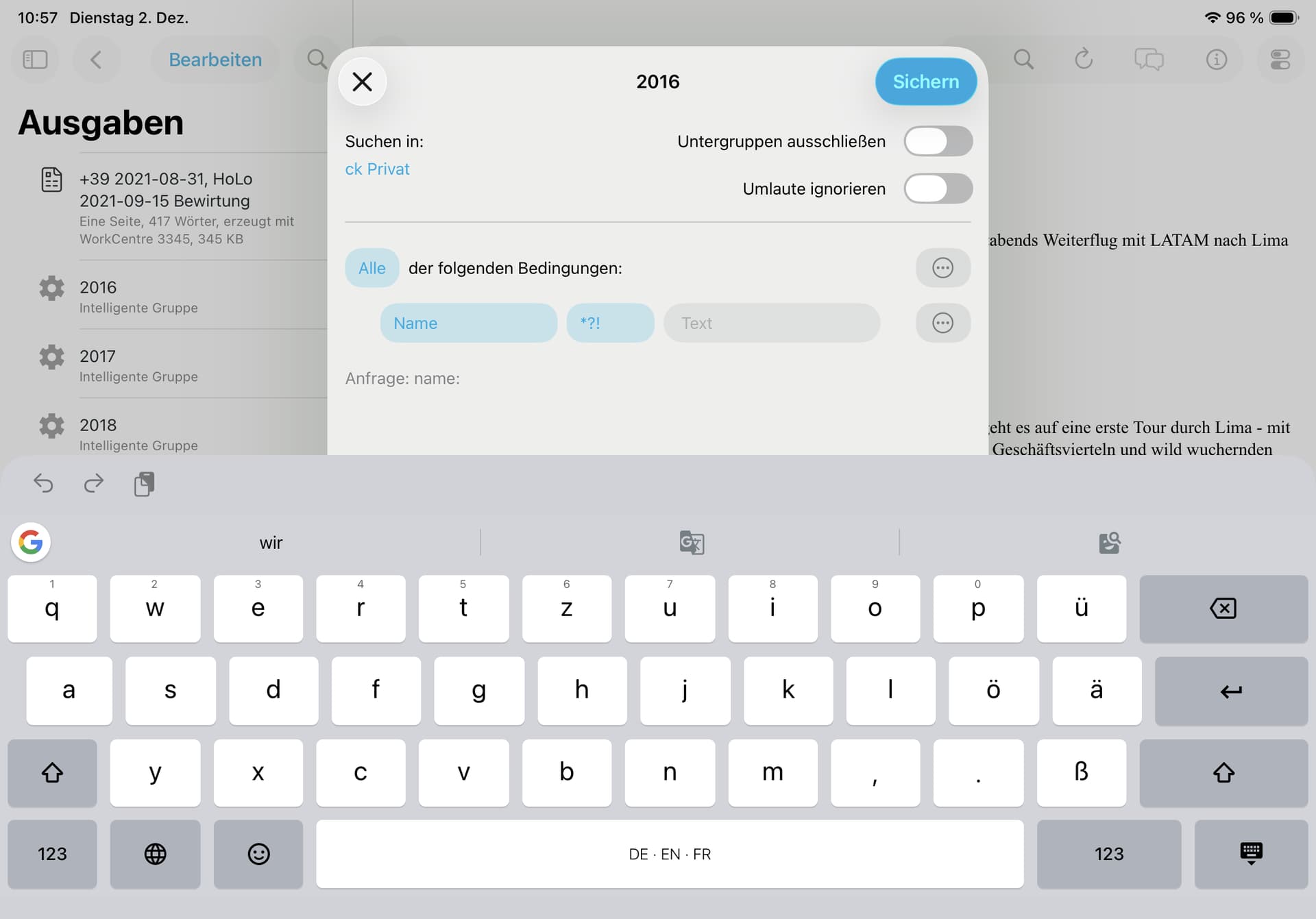

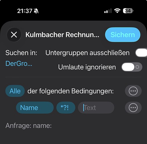

I’m seeing something similar, so chiming in. On macOS:
On iPad with DTTG4:
Needless to say that the content of the smart group on the iPad is bogus: The group reference is wrong, as is the search condition.
Shure:
And how does that look on the iPad/iPhone? Would be helpful to see how the conditions are carried over.

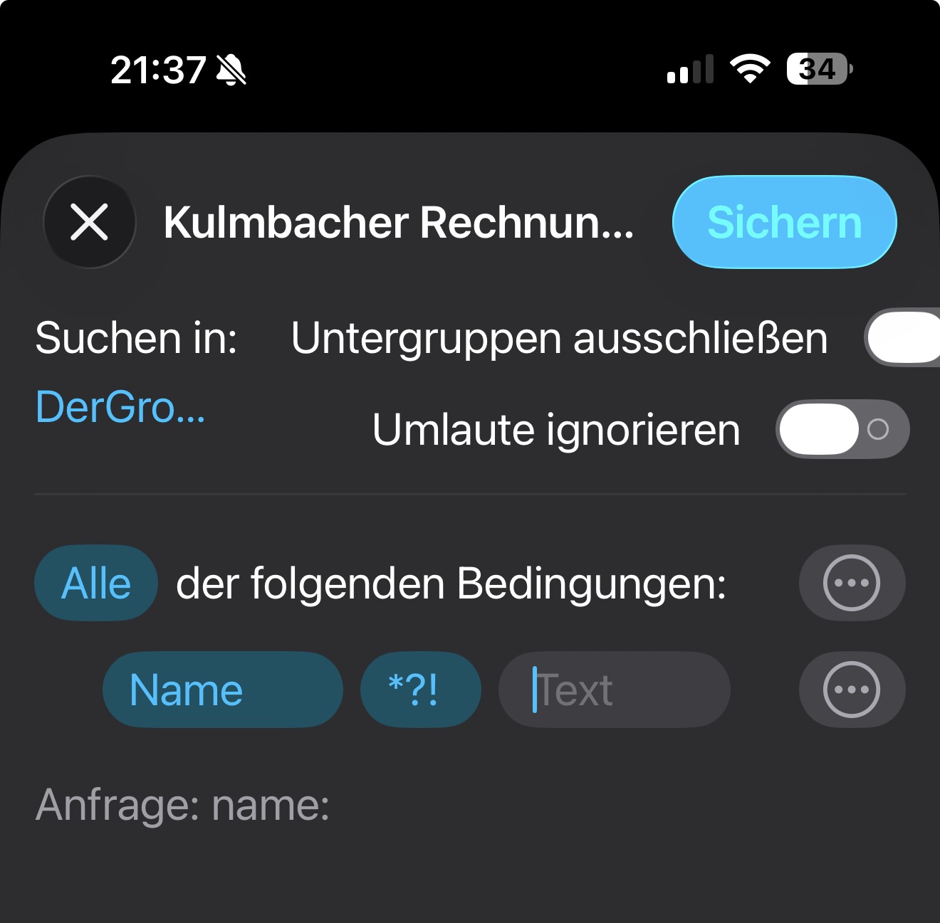

Just checked on the iPhone:
Does not look like on the Mac…
W:
Exactly… No wonder that the smart group selects a ton of documents in DTTG.

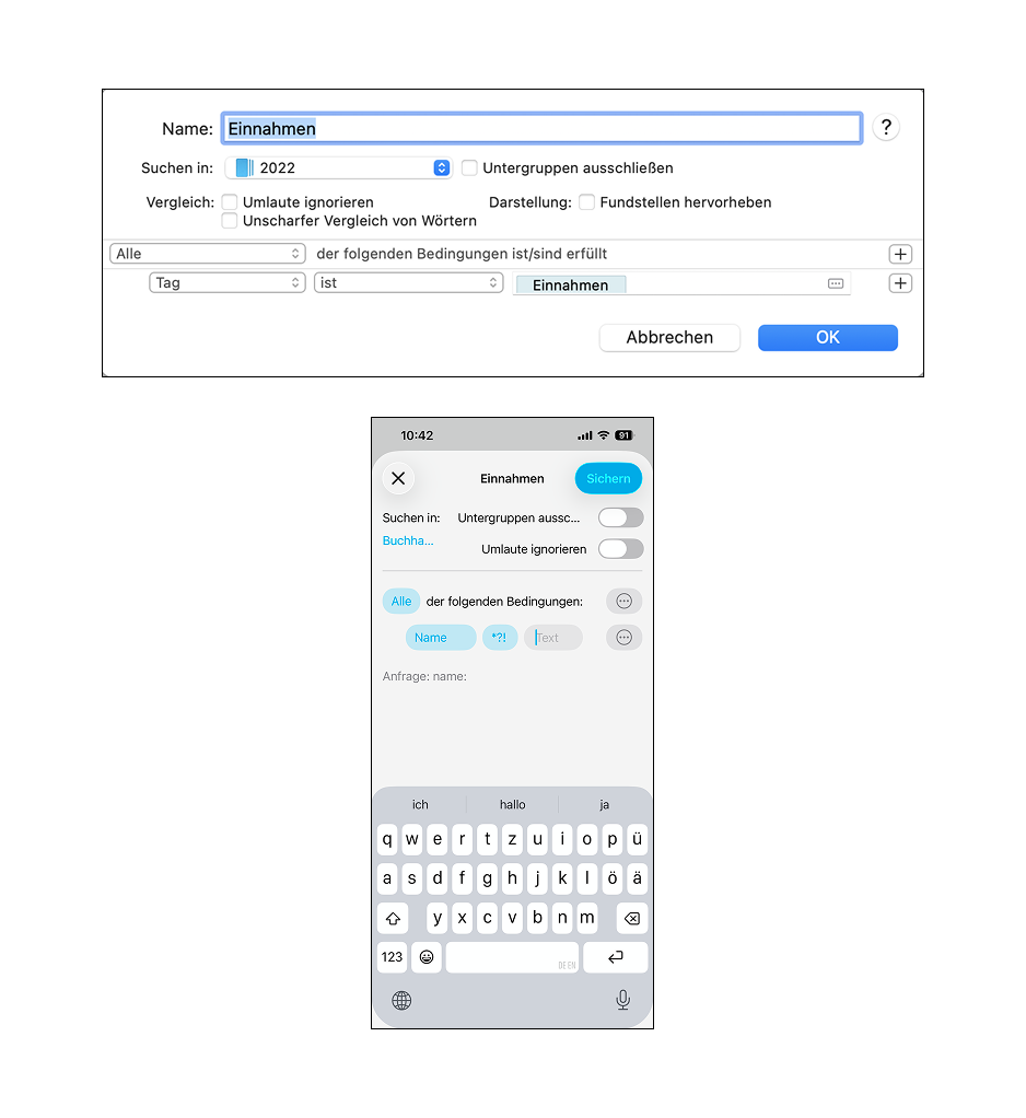

The problem doesn’t only happen with multi-word tags but also with single-word tags. Here are two screenshots of the same smart group on macOS and iOS as an example.
If there is anything I can help with testing to narrow down the source of the problem, let me know.
How do you synchronize the devices, meaning what kind of sync location? Did you migrate the database(s) from DEVONthink To Go 3 or import fresh copies?
I sync via Dropbox.
The latest version of DEVONthink To Go 3 was installed on the iPhone when I downloaded DEVONthink To Go 4 and is still installed on the same iPhone. So I guess the databases were automatically migrated.
Did you use DEVONthink To Go 3 and this Dropbox sync store for a long time? Then it’s possible that the databases do not yet contain the necessary information. Does modifying a smart group on the Mac (e.g. by renaming or flagging it) fix this?

Renaming a smart group on macOS fixed the sync issue partially. For single-word smart groups, instead of the whole database, only the desired content shows up on iOS. For multi-word smart groups, instead of the whole database, nothing shows up on iOS.
