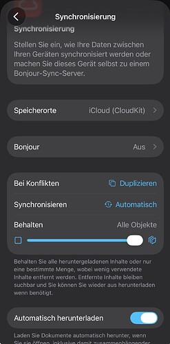

What are the sync settings for each sync location in DEVONthink To Go?
Thanks for the clarification.
Concerning the sync settings, I post a screenshot. They are the same for both iOS devices.

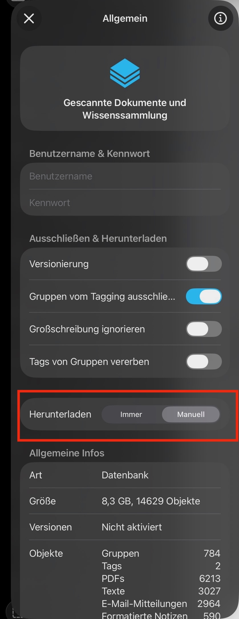

However, when I do a long press to the database, I see the option to change between “always download” and “manual download”.
I’ll attach a screenshot of this view.
This option is under no circumstances changeable I tried so far .
I don’t know if this option is just an artefact from my years old database, but its there and I can not change between these two options.

I faced the same problem, and the solution is easy, but rather unintuitive:
  1. Go to Settings > Synchronization > Locations
  2. Tap Edit
  3. For each sync store (Bonjour, iCloud, …):
    • Choose Edit from the three-dots-menu
    • Set Download Files to On demand
  4. Go back to your database list
  5. For each database:
    • call up its properties (info button), and choose Download… > Always or On demand
Only after all sync stores are set to Download On demand does switching become possible for each database.

Thank you, this did the job.
So if I get the intention right, it allows different decisions per database on the question, if anything should be downloaded while syncing.
However this gets overruled if you define via a sync store that all files should be downloaded, which then would be the case for all databases.
Makes sense to me, but from a UX perspective, I think bringing these options together in one view and explaining how they are connected, would be a good idea.

That is correct. And you can’t have a mix of the two, so you can’t sync a database, e.g., Bonjour set to a full sync (Download Files: Always) and Dropbox with a shallow sync (Download Files: On demand). Those are contrary options.
