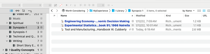

I noticed one of the groups in my Index had a -1 suffix (Synopsis-1). I don’t believe I added the suffix. I checked OS and its folder also had the same name as the group (Synopsis-1). I then opened that group this AM and did some editing of a .rtfd file in it, clicking on the photo in the file .

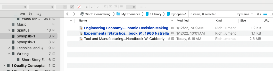

When I was done editing, I noticed that there were now 2 groups with the same name (Synopsis-1). I did not create the second group.

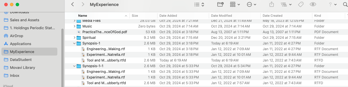

When I checked OS there were also 2 folders, the original with the -1 suffix and a new one with a -1-1 suffix. The only difference I could tell was in the Added and Modified dates of the .rtfd file. in the -1 folder the Added and Modified dates were today’s date, while in the -1-1 folder the Added date was October 29, 2024 and Modified date was January 12, 2022.
I’ve attached screenshots of the duplicates in DT3 (one with the edited version and one with the original RTFD) as well as Mac structures.

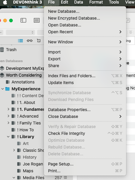

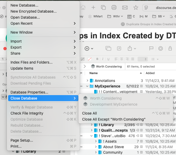

At your suggestion, I tried to Verify and Repair, but those options were grayed out. See Screenshot. I did run Check File Integrity and it reported Invalid File Integrity for a file, see screen shot,
File Integrity Error

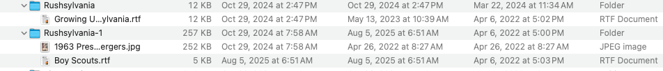

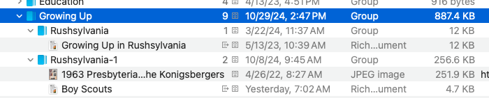

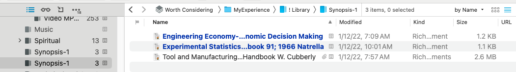

and as I investigated I found another of the -1 suffix groups, The -1 contains an additional file while the group without the suffix does not show the file. OS reports the Date added as the same, but different creation and modification dates, See Screenshot and by the way that error did not show up yesterday when I verified.
In an effort to Verify and Repair, I tried to close the database, but it was grayed out.
I’m going to have to shut down and restart. I’ve never had this happen.

I don’t know why the option to Verify and Repair was Grayed out at my previous post. But after quitting DT3 and restarting my Mac, I was able to verify and Log reports “Successfully Verified”.

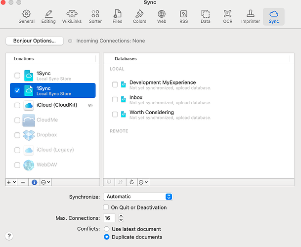

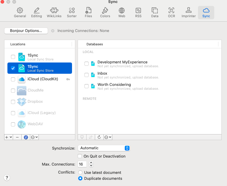

I’m attaching a screenshot of my Sync Locations and Databases. Looks like Conflicts is set to Duplicate Documents. But I don’t know what that means.
Sorry for that. I thought I answered all your questions. What did I miss? I covered what I know about Smart Rules and external processes. I covered my need for using indexing. I’ve covered Verification. I’ve covered the state of my Index Log.
You have a sync location, but you do not sync any databases? Perhaps turning off “Duplicate documents” helps.
I’m not competent on the “Sync” options. It looks like the options to conflicts are either “Duplicate documents” or “Use Latest Documents”. I don’t see an option to turn them off. I could turn off the Sync to “Local Sync Store” but I don’t know the implications. I do want DT3 to sync to my local index folders.
