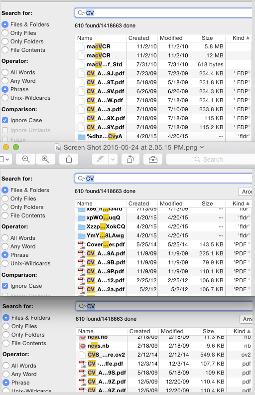

just searched my computer for all files containing the word “virus,” and ordered the results by KIND. My pdfs are not all grouped together. Toward the top, after the folders, it lists a large number which it calls “'PDF '”; lower down, there’s a smaller group, which it identifies as “pdf”.
I’ve attached a screenshot showing both. Any idea what’s going on?

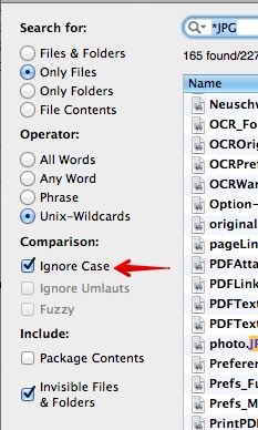

You have this unchecked as pdf is not equal to PDF.
Hi Jim,
Thanks for taking the time to reply. And nope, “Ignore Case” was already checked for that search. [See new expand screenshot collage, below.] Note that the “Ignore case” option in EasyFind applies to the search term only, which in my case was “virus”. It thus does not help with the problem of “pdf” vs “'PDF '”. Note also that the difference isn’t just case, it’s:

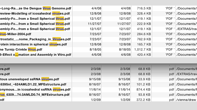

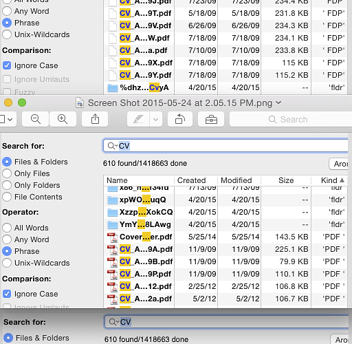

In addition, I found there’s a third designation EasyFind uses for pdf’s: "’ FDP’". Note that here it puts the space at the beginning (i.e., before FDP) rather than the end (like it does with PDF). See attached screenshot. [EDIT: I JUST NOTICED YOUR WEBSITE CUTS OFF THE RHS OF MY PICS, SO IN MY FIRST POST YOU COULDN’T SEE THE pdf OR 'PDF ’ DESIGNATIONS UNDER THE “KIND” COLUMN. THE SECOND PIC, HERE, DOES SHOW THIS. IT COMBINES SCREENSHOTS FROM THREE DIFFERENT SCROLL POINTS FROM WITHIN THE SAME SEARCH. THIS SEARCH WAS FOR “CV”.]

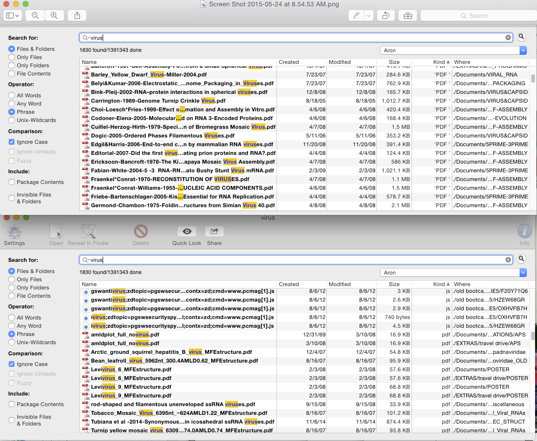

I’ve checked what Spotlight does with these. In Spotlight, what EasyFind calls “pdf”, “'PDF '” and “’ FDP’” are most commonly called “Portable Document Format.” However, there is a second category of pdf’s that Spotlight identifies, which is “Adobe PDF document”; the few of these that I’ve checked are identified by EasyFind as “pdf”. So basically Spotlight has two categories of pdf-type-documents, and EasyFind has three, and these are different and thus overlap.

Truthfully, there isn’t a problem here. The files with ’ PDF’ are made by an app (likely an Adobe app) that still adds a Creator and File Type (which is what the ’ PDF’ is). They were deprecated by Apple years ago but they still persist in some apps. The other files which just read pdf, have no Creator or FSFileType but are mapped via the UTI as a PDF file. The one with ’ FPD’ has been issued a different (and possibly incorrect) FSFileType but the UTI from the extension still maps it as a PDF file.
If you want you can start a Support Ticket and attach an example of the FPD file.
Also, you having the ability to modify a file extension is not a good idea to exercise in most cases. I can change the extension of a PDF file to .rtf which will change its UTI (universal type indicator). However, this makes it a kosher RTF file no more than changing my name to Prince Charles makes me royalty. 8)
Right now EasyFind displays either the extension or the HFS type, a future release will unify this and display the same kind as the Finder.
