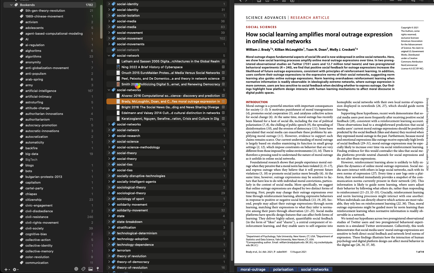

Why is editing tags in DEVONthink such a nightmare? I have 1,782 tags in my Bookends library (indexing Bookends attachments) containing 5,685 PDF files. Trying to add or delete a duplicate tag in Globals > Tags > Bookends results in a constant spinning beachball. I don’t understand what the problem is. Too many tags or too many PDFs? Maybe both? Should I give up on using tags when dealing with a large number of PDFs? I’ve already performed all the ‘health’ maintenance, such as Verify & Repair Database, etc.

Yes, but I recently used AppleScript to batch-convert my tags to kebab-case (lowercase, ASCII).
That’s why some duplicates appeared, which I want to merge or remove.
