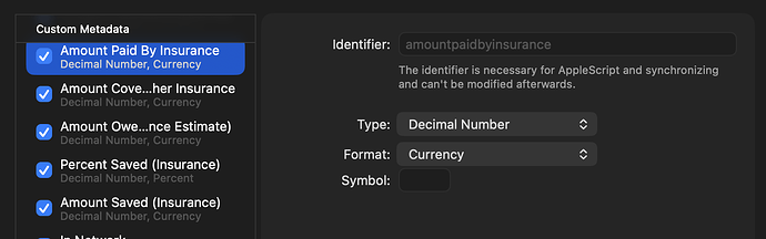

How is your custom metadata field defined? I think @cgrunenberg is in a better position to demistify that mistery.
Zero values and empty strings are currently stripped to keep the custom metadata store as small as possible.
