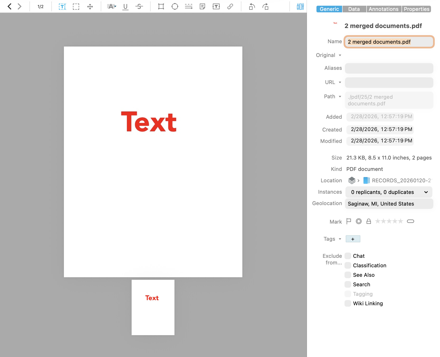

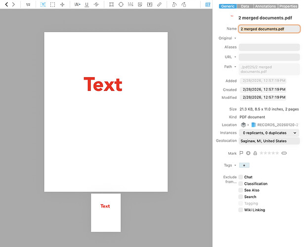

Just to clarify, you’re not doing anything more than switching the listed dpi. You aren’t resampling the image.
Your image has a specific number of pixels, say 1000 x 1000.
  • At 72dpi, the relative size is (1000/72) x (1000/72) or 13.89 inches.
  • At 300dpi, the relative size (1000/300) x (1000/300) or 3.33 inches.
Yes, the larger dimensions will govern the page size of a converted PDF document but it’s something you should be aware of.
And both images are the exact same file size.
