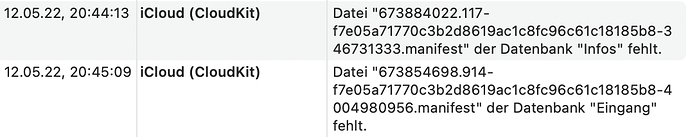

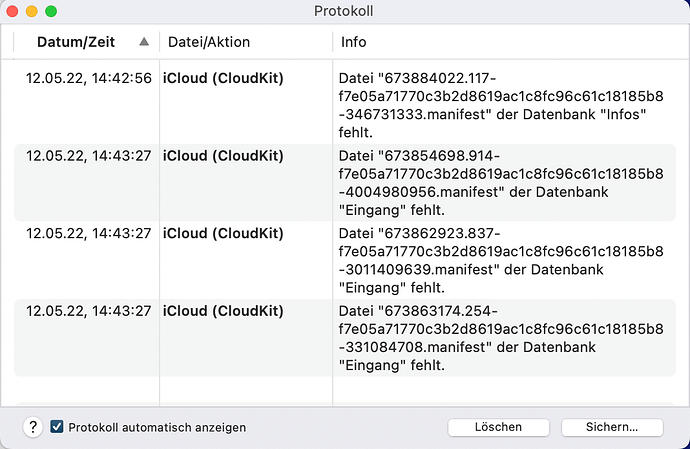

OK, that’s what I thought it is. There is no function that says ‘clean/bereinigen databank/’; it just says something like fast check (and this what I did). Unfortunately the problem remains (see screenshot)

Hi there, did everything as you said, cleaned the database … but the problem remains if I sync via iCloud (which would be my preferred option). So emptied that as well, re-established everything from scratch, but I still get the ‘manifest’-messages …
This is really strange and the problem occured from one day to another and in my many many years of using DT I never had this (or any other problem either).
