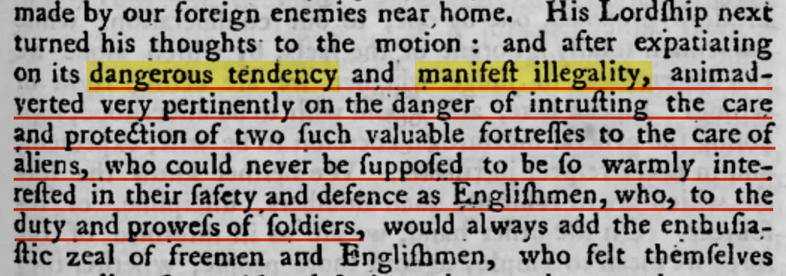

My notetaking often involves copying text from 17th and 18th century documents. Luckily, the PDFs I have are either OCR’d or I can get DevonThink to OCR them. Less luckily, between scan quality and (especially) different orthographic conventions, it comes out a little garbled. Like, you can figure it out, but it slows you down and (especially) it may interfere with search efficacy.
Here’s an example. First, the original PDF:
Now, the pasted text in a RTF notecard:
palain text
To be clear, I’m amazed the OCR does as well as it does! But both for efficiency of future reading and especially for future search/"see also"ing, I’m trying to think of a way to fix it at scale–at least for the orthography issues.
Take the simplest example of orthographic problems: many S’es actually appear as F’s. Fo it lookf like thif, pretty filly, huh? The best idea I have for fixing this is search-and-replace by word, because obviously I don’t want to replace ALL the F’s with S’es, some of them are actually F’s!
