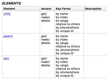

The dictionary portion that I believe is relevant but don’t know how to use.
screenshot_2020-09-17-21-02-57
Did more research, and sounds like I need to loop over the other items in the list and use this command.
screenshot_2020-09-17-21-05-20
