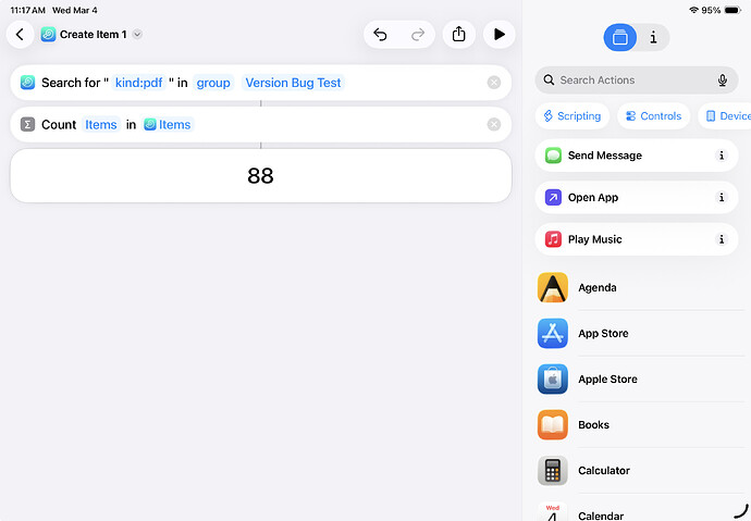

Here is a simple example that works and returns 88 items…
