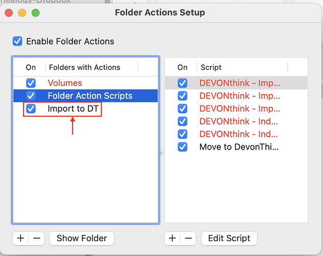

Using DT Pro 4 and trying to set up a folder using a script to make DT import any file I put in there. I followed instructions in Help to add a script to the folder, but the scripts shown are red and don’t appear to do anything. I looked in the scripts folder in Finder (~/Library/Scripts/Folder Action Scripts) and found no scripts. I tried DT>Install Add-ons and the scripts appear in my DT Inbox, not in the Folder Action Scripts folder. In fact, they keep appearing in the Inbox every time I launch the app.

Yes, if by that you mean, go through the Folder Action Setup, select Folder Action Scripts, click + and select a script to apply.
This should be applied only to the desired import folder, not to the folder mentioned above. A screenshot of your folder action setup would be useful, thanks.
I selected the “Move to Devonthink” script.
You should be selecting this and disabling the other two…
OK, I did that. No activity - how long should it take?

And what do you see when you select that folder in the Folder Actions Setup?
You should not have all those scripts enabled, either way.
