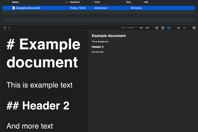

Although I understand I can change the display style using CSS, I do believe that the default viewing size has a problem:
I have the following simple example document:

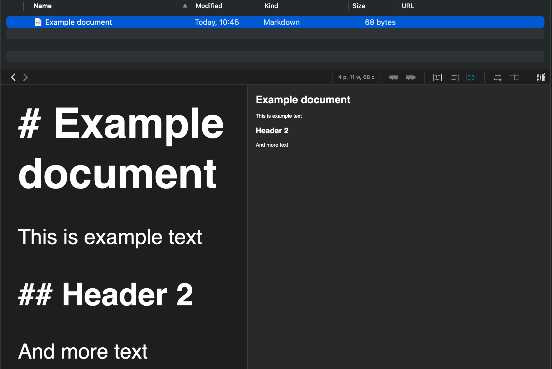

As you can see the source is well readable and that the rendered preview is not.
I tried increasing the font size using the above mentioned font size of the Rich Text & Note Font with no effect.
Changing the Markdown Font increases the size of the source editor.

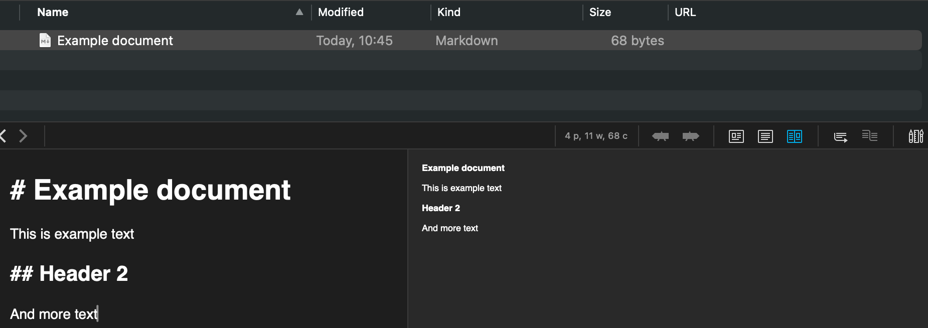

For completeness, this is the view I get when setting both fonts to size 36:

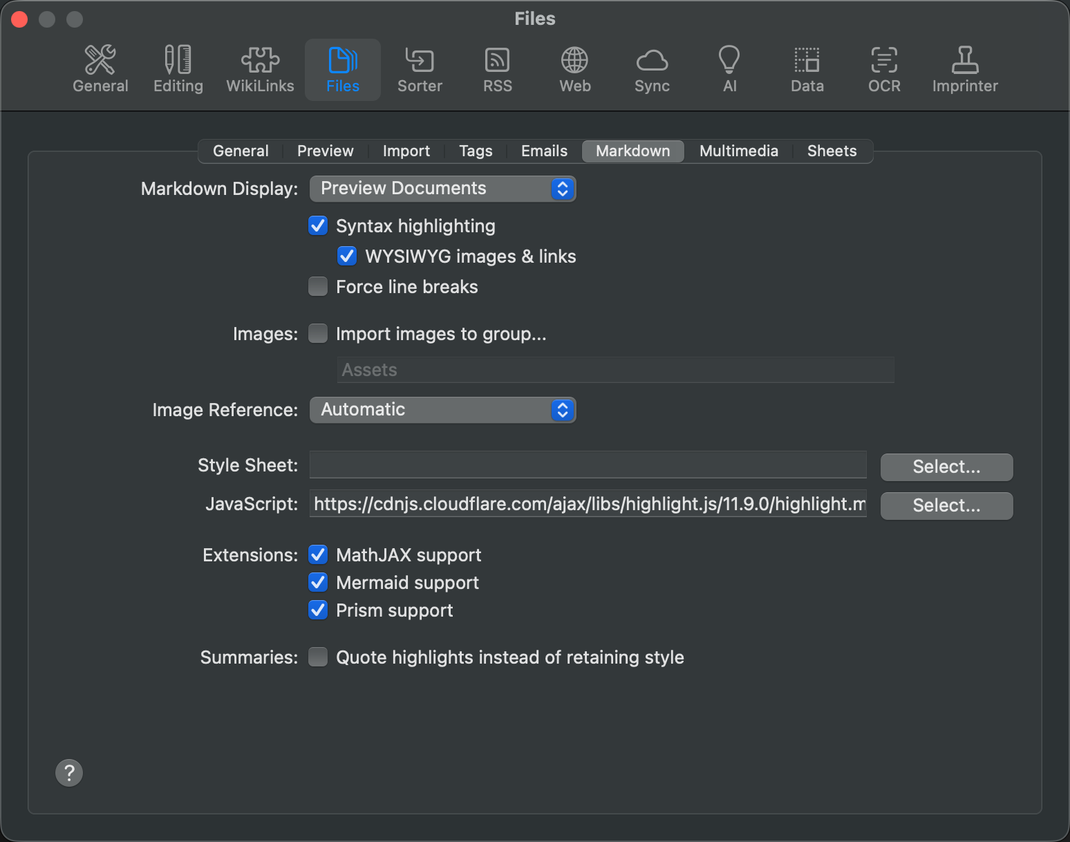

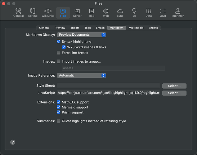

For clarity, I do not have a stylesheet enabled:
Of course, as the rendering of MD is determined only by CSS. RTF and Note has nothing to do with that.
Of course, as the rendering of MD is determined only by CSS. The MD font has nothing to do with that.
If you want to influence the appearance of the rendered MD (which is HTML), you must do it in CSS.

Switch to View > Document Display > Preview, then use View > Zoom > Actual Size. Does this fix the issue? If not, then the source view might be zoomed. Switch to View > Document Display > Source and again use View > Zoom > Actual Size

There’s a dedicated Markdown font since version 4 which is used by the internal, dynamic default stylesheet. Without a custom style sheet both the source and preview should be quite similar without zooming.
Indeed, that does what it says it does. And the manual for version 4 correctly explains the role of these presets.
This fixes my problem!!! Thanks.
I used a pinch on my trackpad to correct the zoom to make it visible before. Apparently that pinch is temporarily where the “zoom in” and “zoom out” are sticky. Perhaps you should consider to make a pinch sticky as well.
Anyway this resolves my problem.
