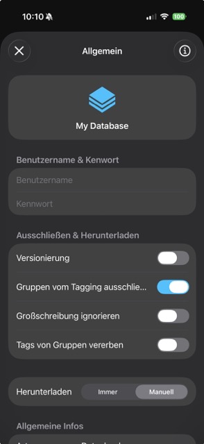

Hey I have Devonthink 4 running on an iMac as a Bonjour Server. And now I have DTTG4 installed on my iPhone. I have connected the local bonjour server both are running. But no pdf files are being downloaded. In DTTG settings - sync - locations the option Files downloading is set to Always.
BUT wenn ich long press the database there is an option called downloading which is set to Manual but I can NOT change it to Always.
Was the database imported from another sync location?
