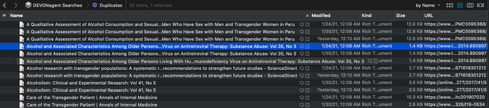

- When I moved them from the inbox into my database, DT identified all of the new items as duplicates.
- I recognize the articles as ones I read last week, and it turns out the week before.
My search set ran again this morning as scheduled–and I got just a few new results and 30ish results that are duplicates from the previous searches. It’s easy to see which ones are duplicates so that I don’t need to review them–but I wonder if I’m doing something wrong that it’s not filtering previous results out…

Yes, they are being added–and GAH! I ran it again tonight and got 12 brand new results, no duplicates…so maybe there were a bunch of versions of some of those earlier results and I finally got through them.
